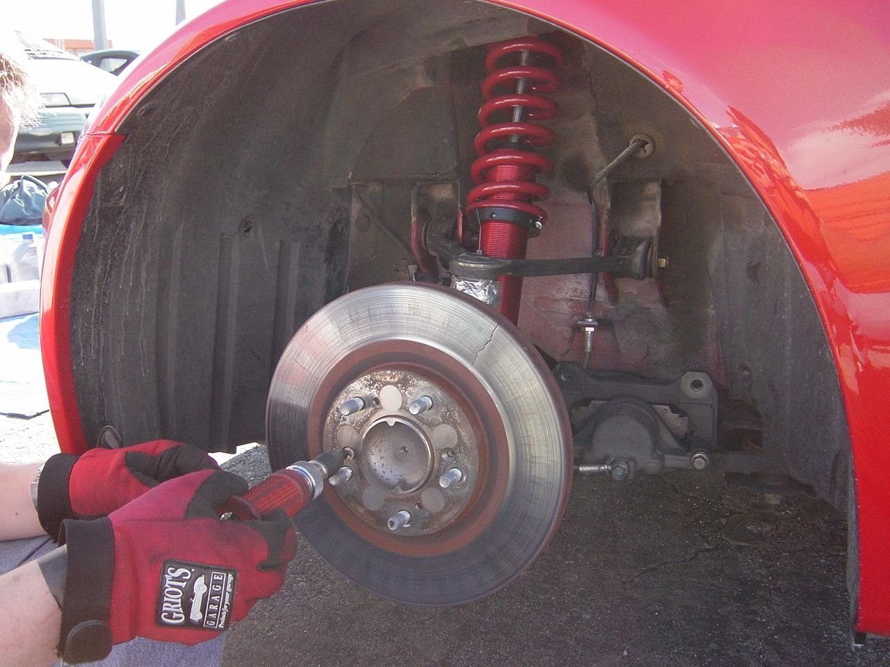

Just so this topic is officially beaten to death...
The photo I posted above is "before;" I was able to use that rotor for, uh, exactly one more track session. Here is "after:"
Yes, I just run 'em till they break.
Note the impact screwdriver: use it with a small sledge to loosen the screws. I replace them too, but without antiseize; instead I just carry my sledge and impact driver in my toolbox (and a spare set of rotors in the trunk!).
