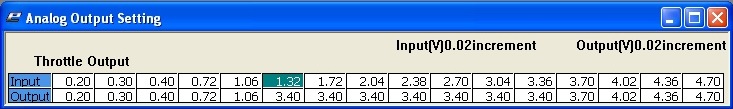

To briefly explain the Analog Output Setting a little more clearly and how it is used, below is how I have set the adjustments on this shared file:
On our s2k's, 0% throttle is around 0.25 volts and 100% throttle is around 4.50 volts. Every car will be slightly different, but you can connect your laptop live with the EMU with the ignition switch on (car not running) and then under the Throttle tab, you can play with the throttle and observe the corresponding voltage at every TPS point. As I mentioned previously, I discovered the OEM closed/open transition point was at 3.34volts or 73%TPS on my vehicle. You can hook up a scan tool while playing with the throttle to verify the closed/open transition point for yourself. Clearly, the TPS position solely defines whether the car is in closed or open loop.
Knowing this, we can modify the output to a fake TPS setting that forces the car into open loop. Note all the 3.40's in the output row. I rounded up a bit (from the 3.34 volts) to add a little fudge to guarantee you all should be in open loop. You still should verify this for yourself and may need to adjust the number slightly higher if necessary. Now take a look at the inputs and observe the highlighted 1.32. 1.32 volt TPS input on my vehicle corresponded to 25% TPS. So what we are saying at 25% throttle, trick the ECU into thinking we are actually around 75% throttle (3.4 volt output). We continue to trick the ECU by keeping 3.4 volt outputs all the way until the input numbers are greater than 3.4 volts, then the outputs can match as they normally would.
Looking again at the 1.32 volt input, if you desire to enter open loop sooner, then change this voltage value. For example, 1.10 volts on my car = 20% TPS. 1.52 volts = 30% TPS. You can play around with that value to adjust the transition point. Like Rad mentioned, we could actually feel a little kick when you slowly transition into open loop by this forced method. The higher the TPS transition, the less of a kick was felt. At 30%, the kick was non-existent. At 20%, I felt it and thought it was a little annoying. 25% seemed right where it was starting to fade.

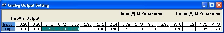

Lastly, when actually dyno tuning, I will temporarily set the Analog Output Setting to the following during the session:
I highlighted the 3 outputs that are changed from the base map. So if following the lesson above, you will see that now I'm calling for open loop at 0.40 volts (~3% TPS). I'll simply do this to know with certainty I am in open loop all the time in order to be able to fill in all load vs. rpm points accurately without having to worry about the closed/open loop transition. CEL's may occur, but I always have a scan tool connected to measure ECT's, so its easy enough to clear codes or see if you have any pending that you can clear before they actually show up.
