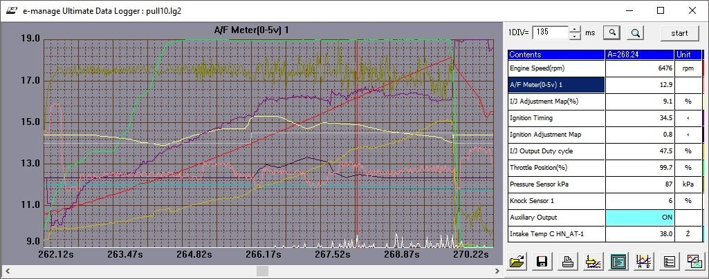

Default Timing and VTEC
Vtec set @ 4.5K
How does my timing curve and fuel look? I am keeping it a tad rich. How much timing can you add on the low cam profile?

Ignition Timing Issue
I have developed an Ignition Timing Issue, if I set any value in my ignition table(s) it loses sync. Do I have a bad EMU unit? The car will misfire at those spikes in the picture above. If I set all the tables to zero, no misfires happen.
