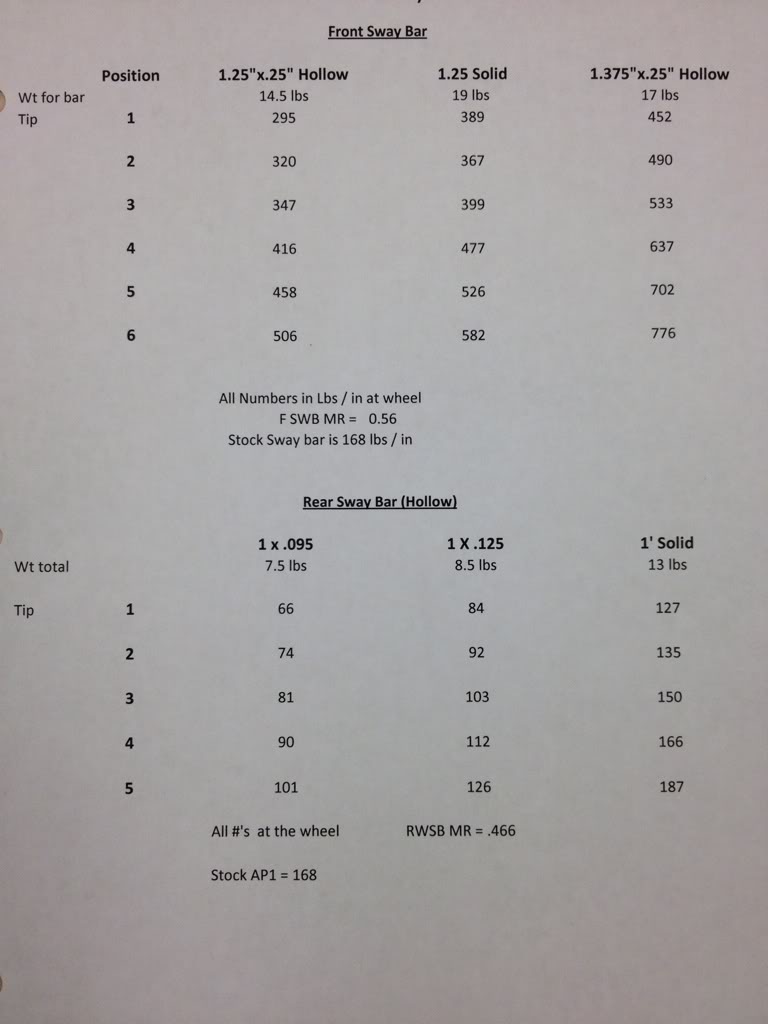

Guys I talked to bill today and wanted to share the news with everyone! He has made a ball-bearing rear sway bar for the s2k. It's hollow using 120 wall tubing and it weights about 8 lbs with everything. He said it has 5 holes and calculating the rates at the wheels the stiffest setting is 110 in/lb or degree/lb (he didn't say and I forgot to ask) and the softest setting is 75 in/lb or degree. He said the stock 00 ap1 rear bar is 230 so that might be able to tell us if he used in or degree.
He said he shipped out the first one the other day and can start making them soon. The price is around $400.

I agree and this delay caused from a soft set-up requires setting up early and ultimatly would mean you can't transition as fast through the elements. Otherwise saying it would be slower because you can't go as fast thought the elements. Correct? People running crazy stiff front roll stiffness but then running a really soft rear roll stiffness would result in a very pushy car I would think unless they dail it out with rear toe-in and/or camber. With a unbalanced roll stiffness I would also think the front of the car will be always waiting on the rear of the car to follow. I think a close to balanced roll stiffness front/rear would be ideal but we have to make the rear end stick.
What center section did you go with Marc? The .095 or .125 wall thickness? I would think the .095 since on the softest setting it's stiffer then the miata bar. This rear bar will be really nice at autocrosses because I can stick/unstick the rear very easily by changing the rear bar setting in grid. I rather change a rear bar setting then mess with shocks.
I went with the smallest center section. The softest setting will be slightly stiffer than the MX-5 bar based on some measurement a customer took for Bill Gendron.

I'll just leave this here..
These came from Bill Gendron him self...
