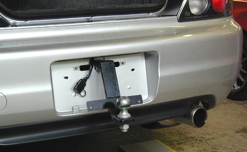

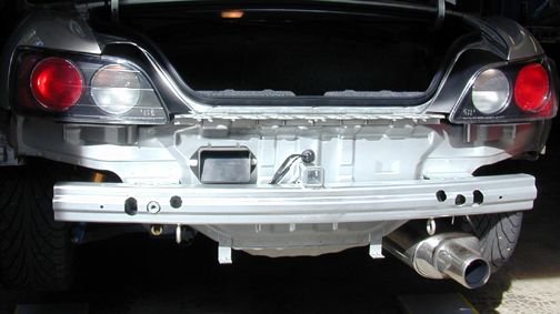

For those do-it-yourselfers, or those who have a good fabrication shop, here is another option.
Purchase a 1-1/4" receiver tube and weld it to the top of the bumper. Cut out the bumper cover to access it. This costs about $15 for parts and total weight added to vehicle is about one pound. It's completely hidden behind the license plate when not used.
I chose this option to keep the installation as stealth as possible and to minimize the weight added to the vehicle.
