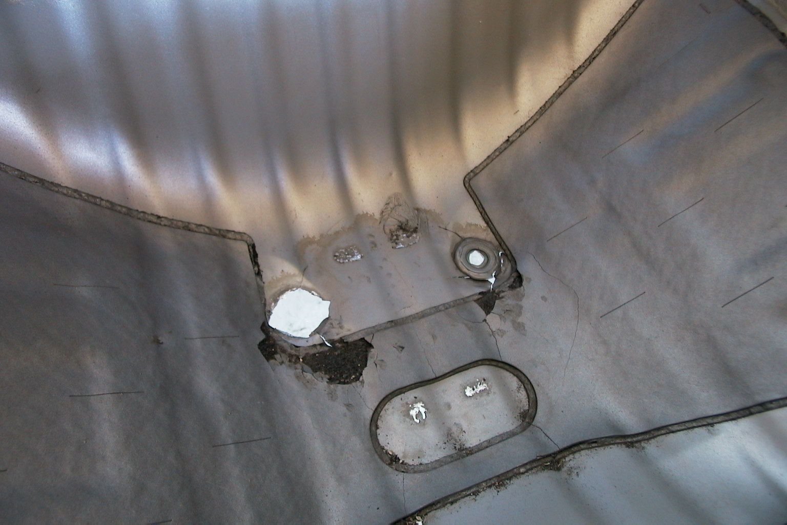

I've had my Gendron hitch for about 6 months, and towed my tire trailer about 2000 miles.
Last weekend after towing to a local event, I noticed that there were cracks in the trunk sheet metal where the forward attachment point is mounted.
The hole on the left is the size of the large fender washer used to hold the piece in place.
For those who just installed the Gendron hitch, I'd think about trying to reinforce the trunk or maybe find something larger than the fender washers to spread the load over a larger area.
P.S. If anyone still wants a Gendron hitch, and has a solution to avoid this problem, mine is for sale.
