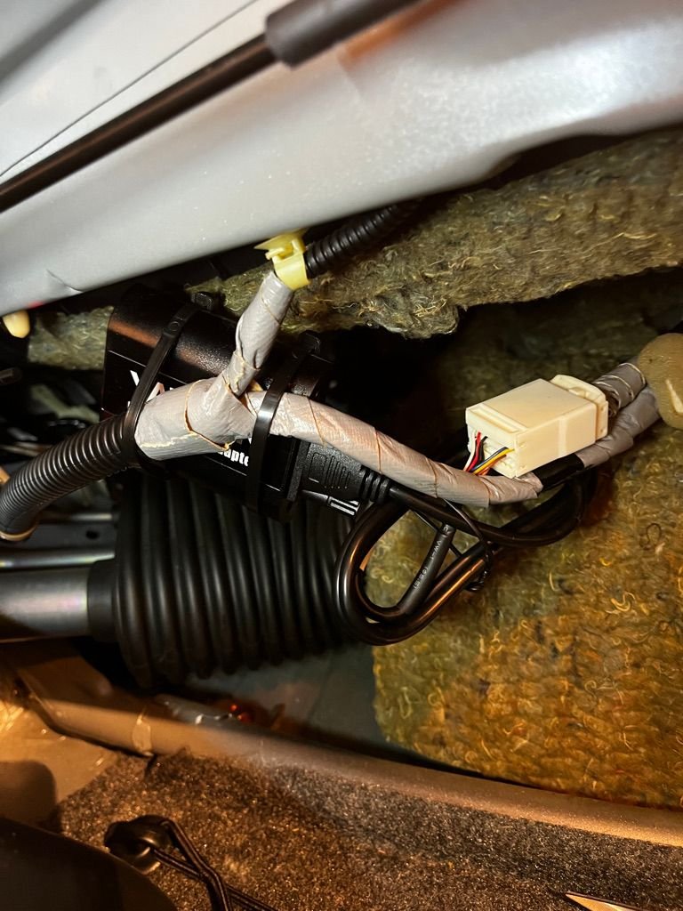

I can also confirm that the YATOUR BTA-HON2F BT adapter worked perfectly with my 2004 AP2. If you look at the pic, I zip tied it (black box/white lettering) to the original gray harness and also zip tied the factory cover/foam separately if anyone ever wanted to return it to stock.
This thread started by Malebolgia was my inspiration with much more detail: https://www.s2ki.com/forums/s2000-el...radio-1212786/
YATOUR BT adapter 2004 AP2
