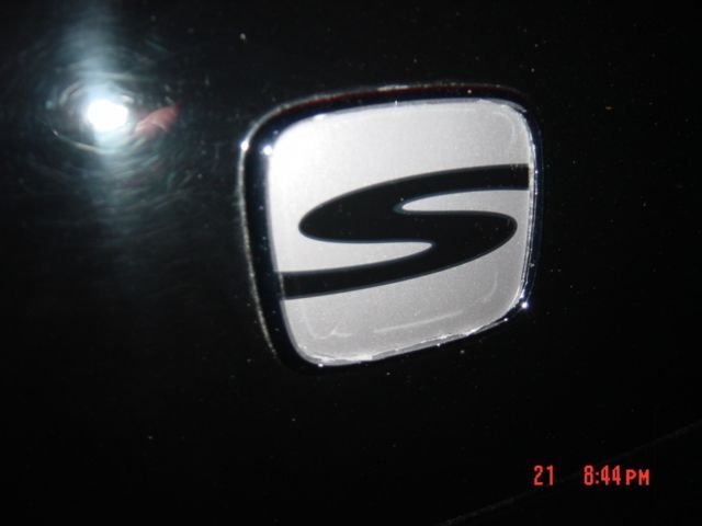

Hi
I'm trying to re apply a portion of the H logo trim to my S front & rear - I've essentially cut the H out and am going to apply the surround part back to surround the S Badges i picked up from Ricks - I've searched S2Ki & not found anything - on the net I've found some products from Dupont & Dymax that are not that easy to get -
Can I get some advice on what product(s) should be used for applying plastic/chrome trim pieces to the exterior?
I've done the trimming on the OEM H Badges - giving them a nice inside bevel so that they'll lay nicely over the S badges & without adhesive they look pretty good (to me) I'll post pics when I've finished the application.
If anyone else has done this & has pics I'd love to see them.
Thanks
Nate03

.Well I used the 3M Plastic & Emblem Adhesive...
I've taken a couple of close up shots - from 6 inches away you can see on the inside of the trim where the 'H's were cut out - from 3 or 4 feet - or from just standing in front of or back of -looking at the car the job looks much cleaner...
I'll post a couple of more photo's tomorrow taken in daylight & outside of the garage...
thoughts - comments?

here's another pic taken from a couple of feet back and without flash - of the rear emblem...
