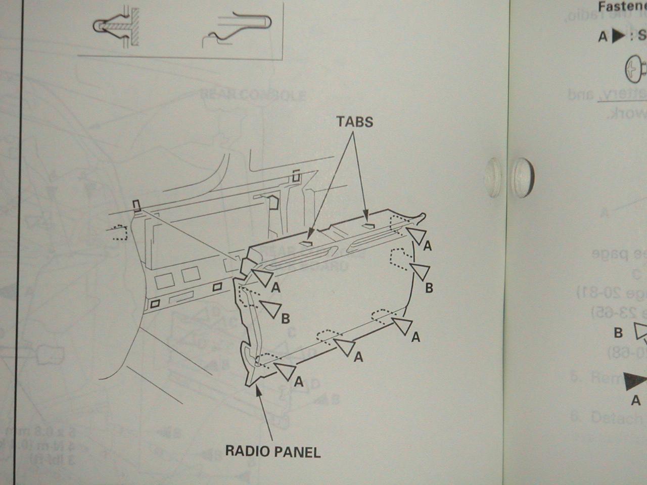

There are 7 clips all together, two at the top of each side and three along the bottom. I start at the top using a butterknife and towel, just above the vents. Once the top leans away from the console a half inch or so, then pull straight out.

If by removing the radio door, you mean separating the door from the frame, it's a bit tricky. First, you have to remove the entire assembly, which is attached with clips to the dash. To remove the door, you have to hammer out the two small pins that hinge it to the frame. I took and posted some photos about this and will look for them later today.
