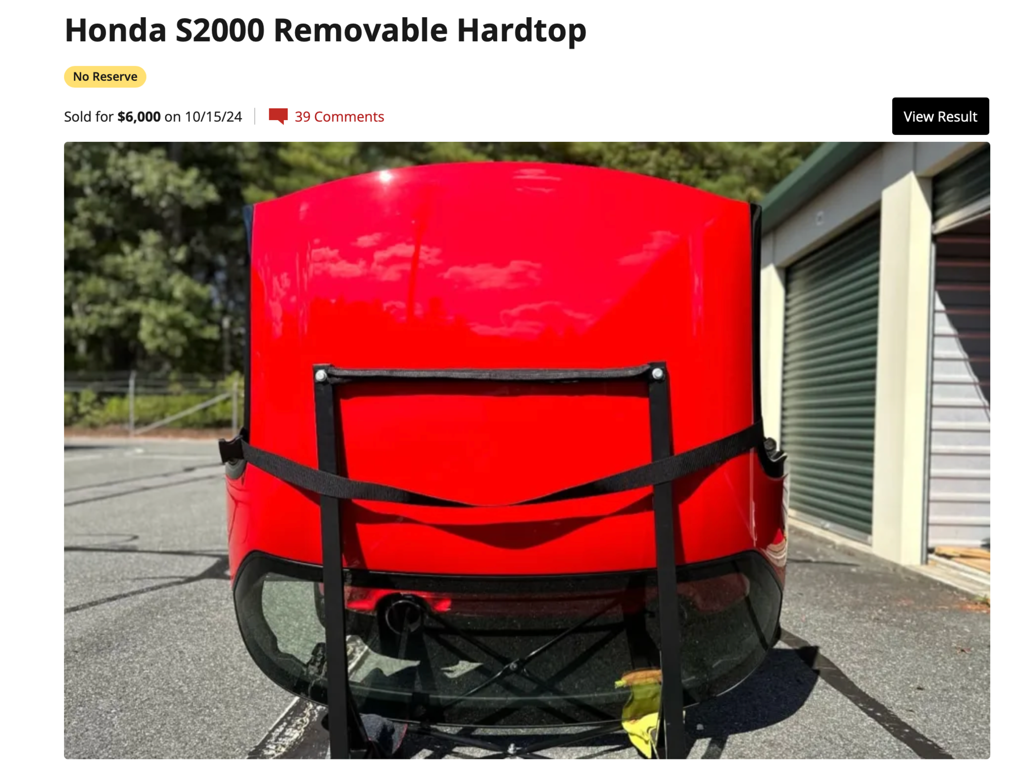

They have been for the last 10 years. When they were $3500 in 2015, I thought it was nuts. I said there's no way people should pay that much money for them. You probably won't lose money if you buy one, it's just a $5500 bill attached to the top of your car.
