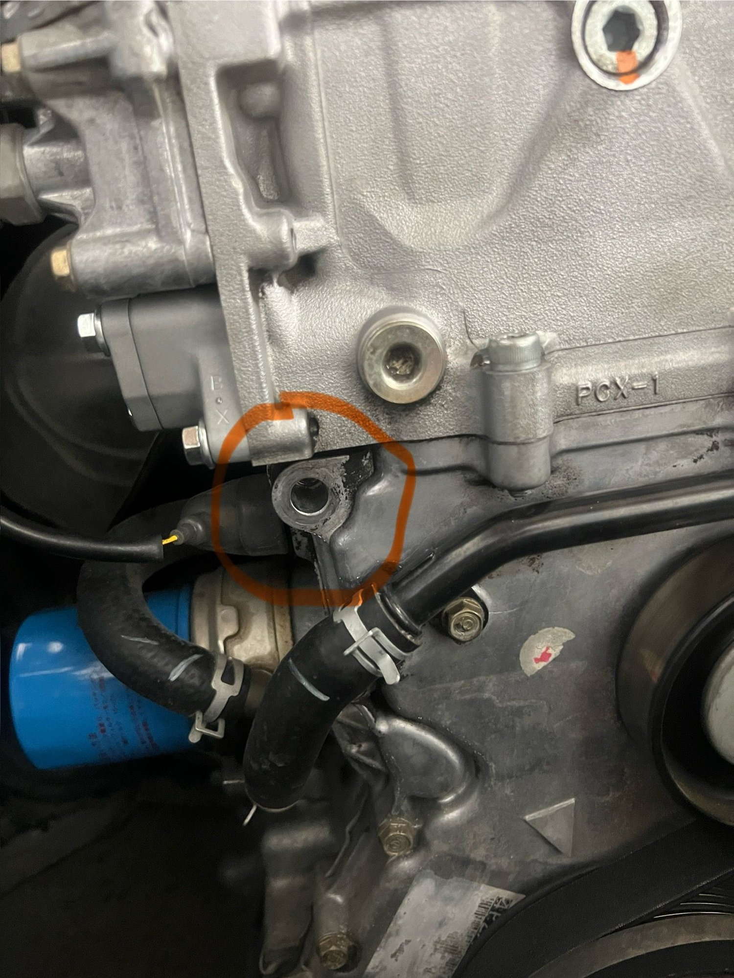

New owner here and my car came with an engine torque damper that I’m looking to remove. The engine torque damper is installed with an extended bolt and I can’t seem to find a diagram that identifies the part. Also would love to know the torque spec for it. Here’s a pic with where the bolt goes that I’m looking for and basically located right by the timing chain tensior.
Thanks in advance!

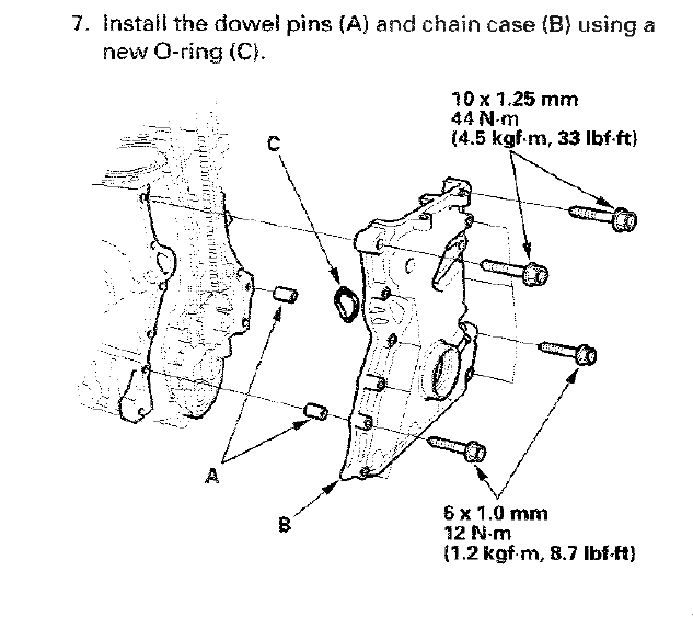

Old Mar 27, 2025 | 10:50 AM
simoncsays's Avatar
Joined: Mar 2025
Posts: 23
Likes: 17
Originally Posted by engifineer
Thank you! Curious was this on Hondapartsnow or somewhere else? I really did try to find it but just couldn't narrow it down enough
Old Mar 27, 2025 | 10:53 AM
engifineer's Avatar
Joined: May 2014
Posts: 7,907
Likes: 2,478
It is in the Honda shop manual. I have a paper copy but I also have an electronic copy of it. Super nice thing to have if you are doing your own work.
