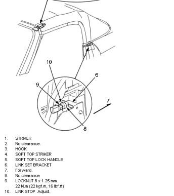

Is there any adjustments on the convertable top to make it shut tighter????

there are adjustments u can do to the top, i dont know how but ther eis a way to may the latches a little tighter by adjusting something....
so im telling you there is a way to make it tighther but i cant tell how how...

Soft top adjustment procedure!
1. Remove both rear tray side trims
2. Close the soft top, then lock it securely by both lock handles.
3. Loosen the locknut of the link stop on each side.
4. Adjust the link stop on each side until it makes a contact with the link set bracket. Keep no clearance between the striker and the hook.
5. Tighten the locknut and check that the lock handle works smoothly on each side.
6. Reinstall the removed parts.
