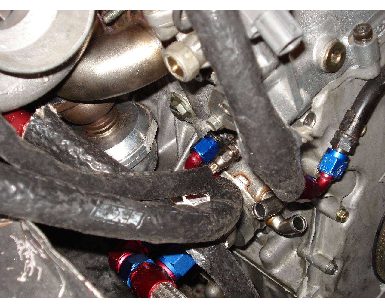

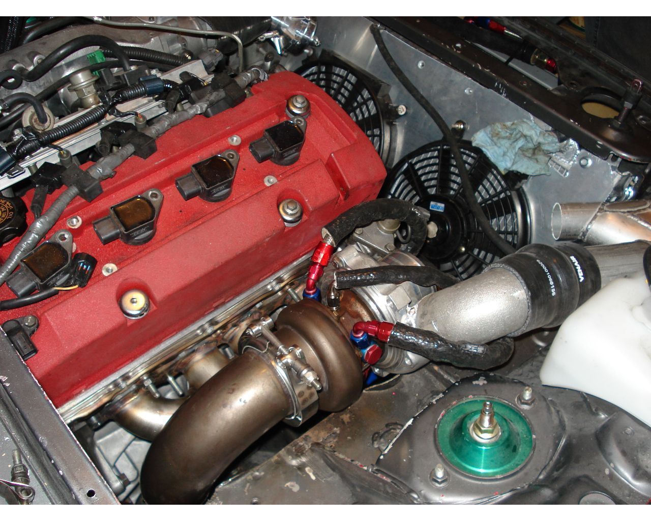

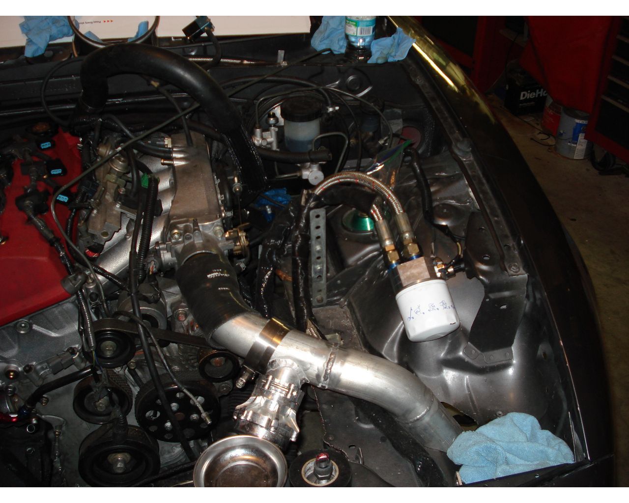

Well, finally I've had time to tinker with the car so here we go:
We replaced the 37mm Koyo with a 57mm Godspeed radiator and fabbed up a shroud for the two fans:
Relocated oil filter and oil pressure/temp sensors:
This is the new oil filter adapter, you can also see the turbo's oil feed/return and water feed/return lines:

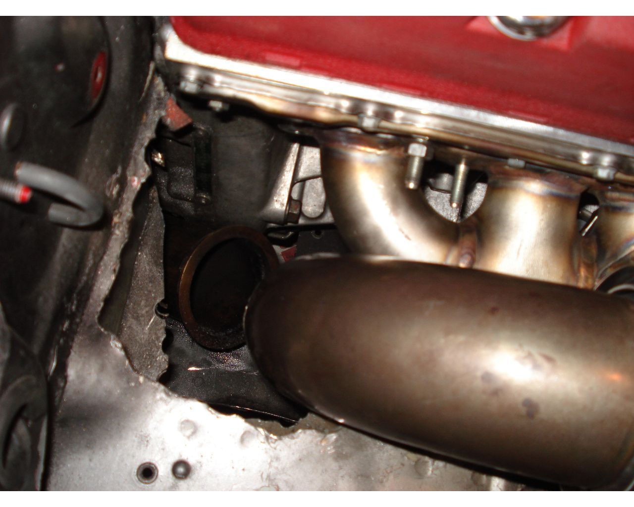

The hole we cut out of the engine bay to run the downpipe for the new top mount PFab log manifold (the downpipe has not been completed yet):
Here's the GT2860RS mounted with all of its lines mocked up:
Another shot:
Front view:
We actually got a lot done tonight, including replacing the 2 gauge battery cable (from the back of the car where the battery is) with a 0/2 gauge cable. We were having problems with the car starting while hot (pulling more amperage), this should solve that.
