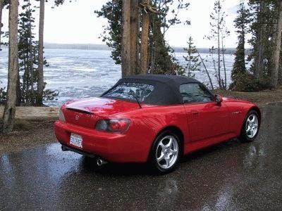

We just got our rear window replaced under warranty at Weir Canyon Honda in Anaheim, CA. Ours was the third they'd done. The first took about a day-and-a-half, the second took a day, ours was done in about six hours. It looks great!
Wow! I can see out the (entire) back window again!
