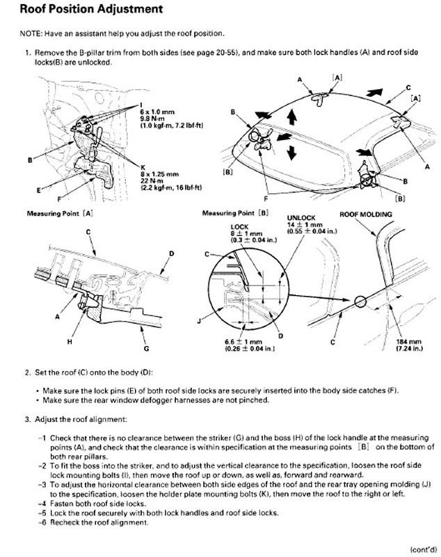

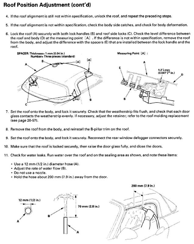

You can order the manual from any dealer or from the info in the owner's manual.
Here are the pages:
jguerdat:
I appreciate your scan but I can't read it. Can you fax them to 949.581.4011 attn. Tim.
Thanks so much in advance.
Tim

You have to click on the link twice to get the actual zoomed in size. jguerdat, thanks so much for the pics.
