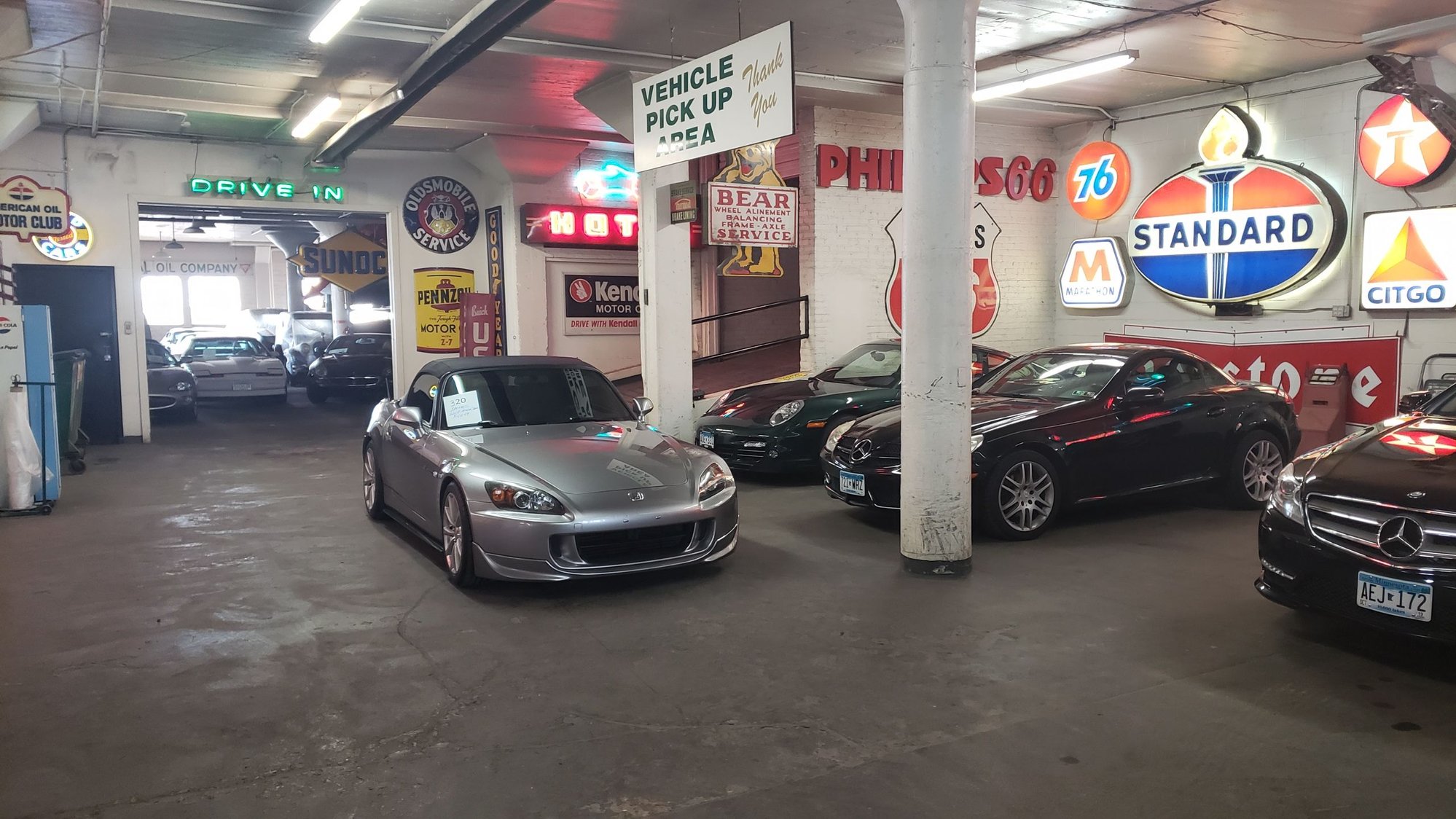

Well - the 2018 season is closed. She went into storage today.
This place takes in 400 cars per year!

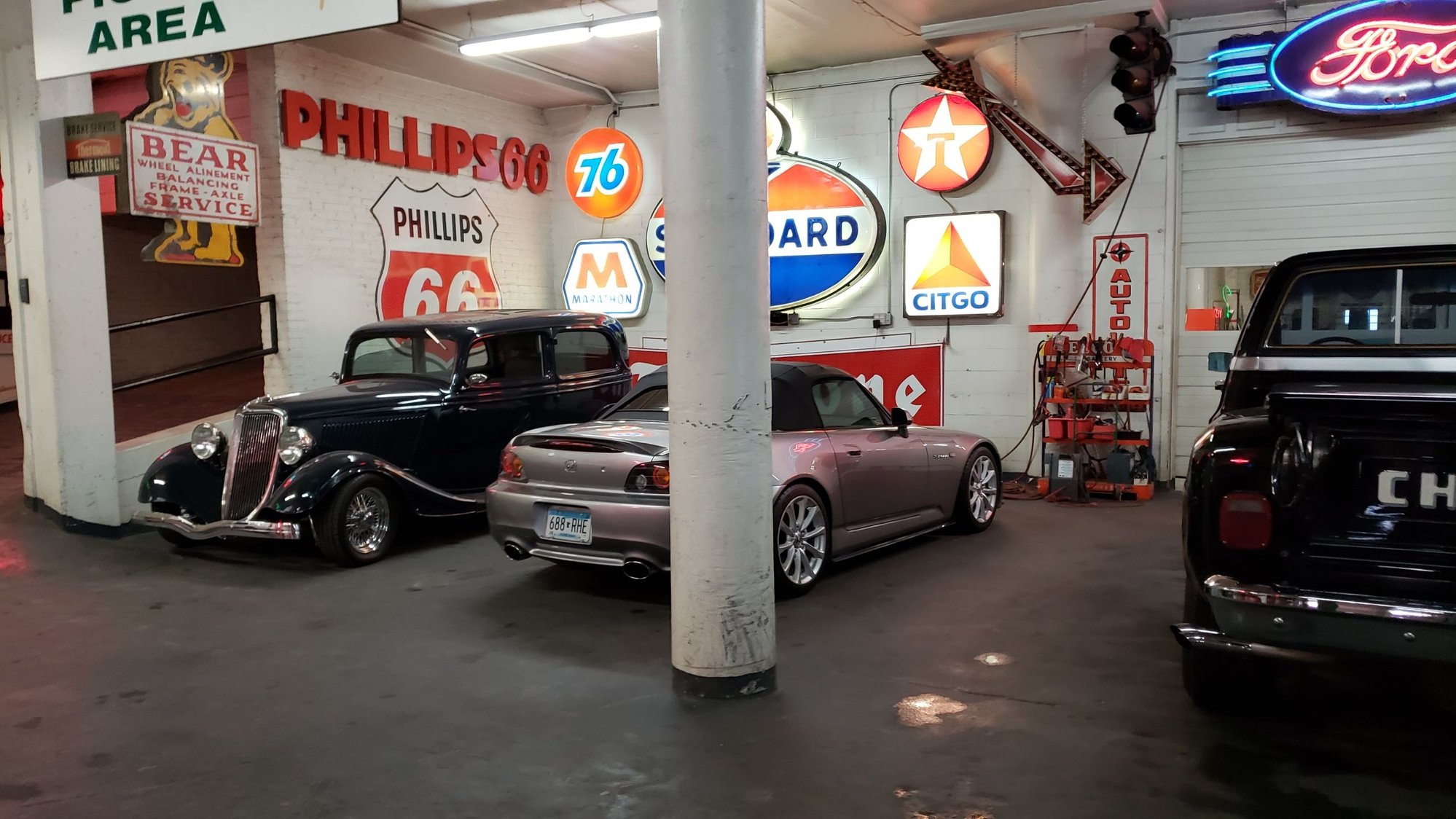

Picked her up this morning from storage...
Man this thing is a hoot to drive! Forgot how fun and raw it is to drive!

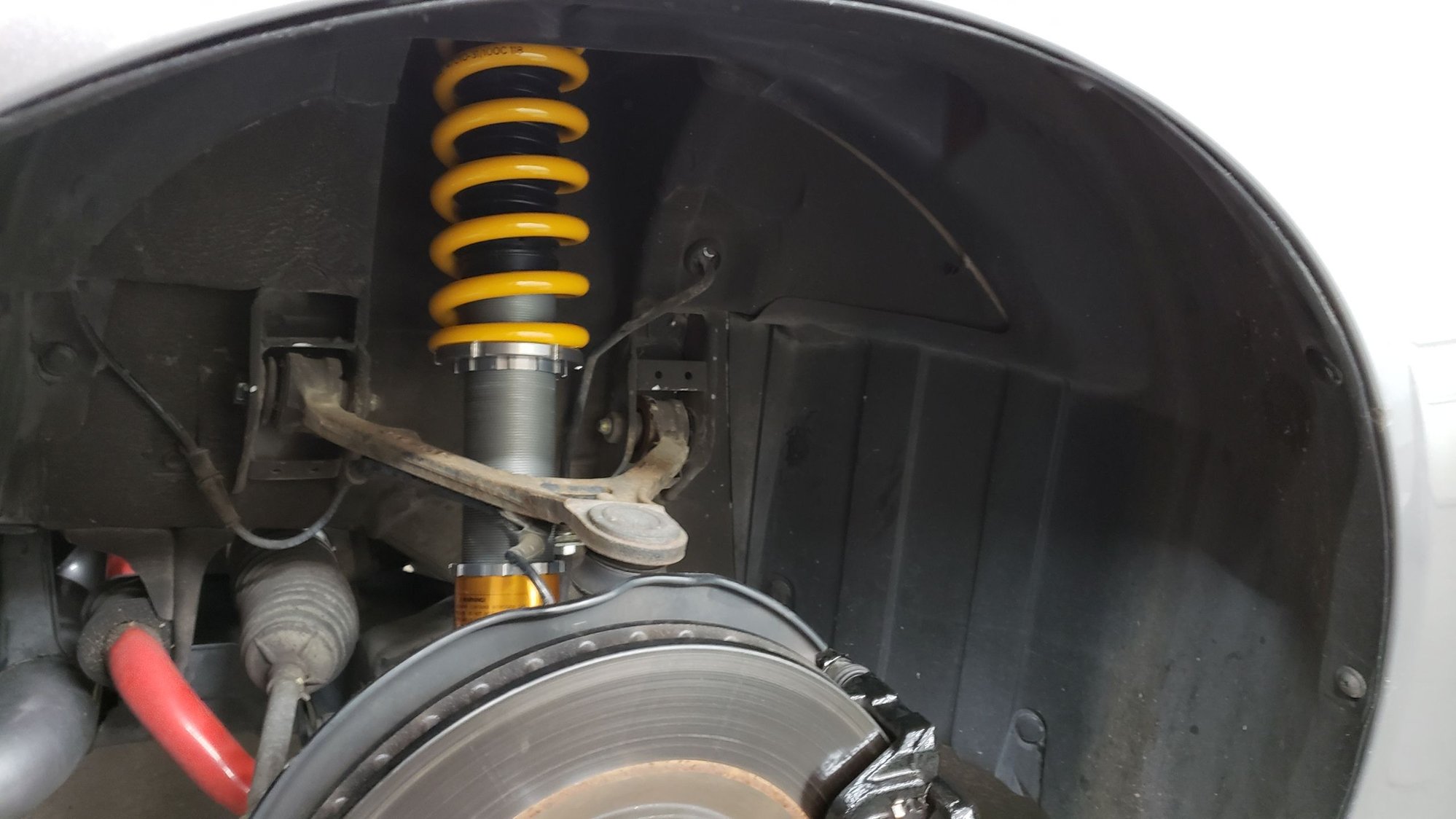

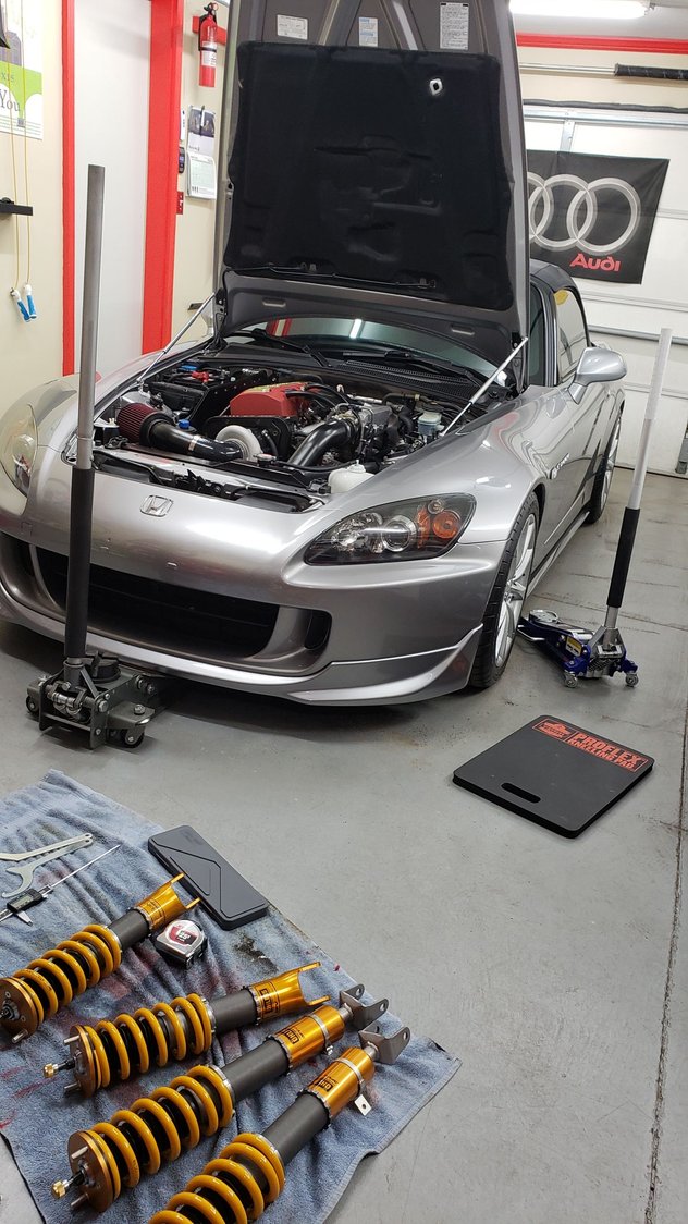

Spent much of today installing the coils. Wasn't particularly difficult...
I spent quite a bit of time setting up the springs so that I'd have the same ride height as I did before but oddly every corner was off by a different amount so had to do some separate tweaking per corner to get it right... unsure if they will settle more or not but I'm guessing I'll have 1 more very minor adjustment after I drive it again and things settle.
I initially set the dampening at 7 clicks as I read some other's reviews that 7 was perfect but it was WAY too stiff. I'm not sure who would like driving around with the suspension like that... I dialed it back to 20 clicks but have only a couple blocks of windshield time with that setting... but it felt much better. I'll get out later tonight and put some miles on it to see how I like it and may make a few tweaks while I'm out (it's quite easy to adjust). The shocks are a lot lighter than the OEM's too.
