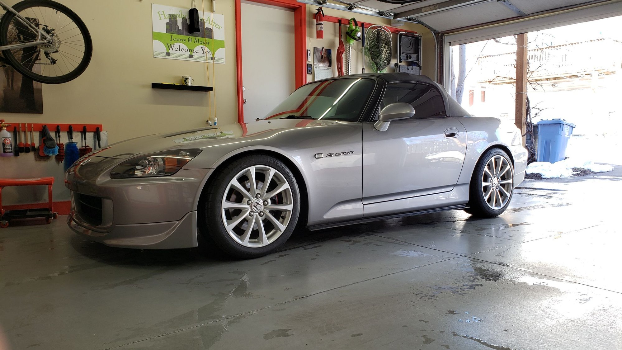

I got the height where I want it...

What brand coils are those that you went with?
I went with Ohlins Road and Track DFV gen 2 (HOS MI21) with the Sakebomb lower cups.

Ride height is on point. Looks sick!
Many thanks. I like a good OEM+ stance.
