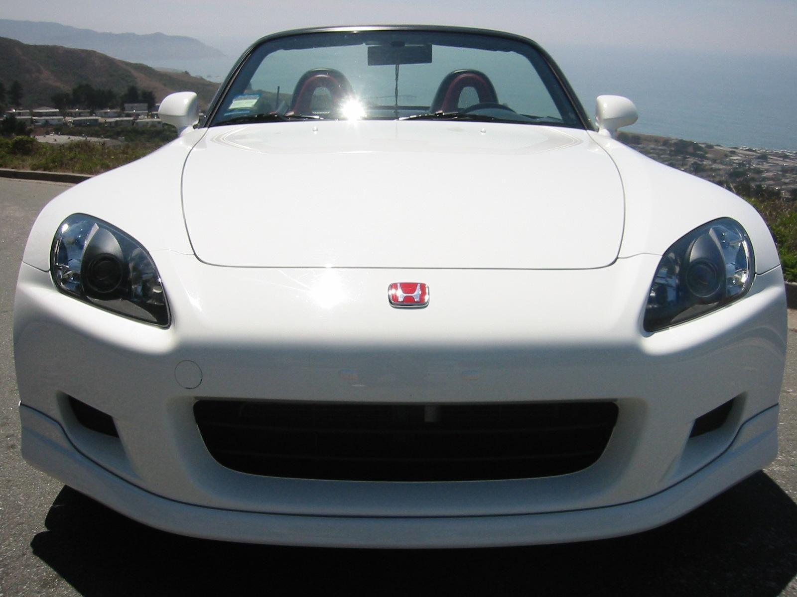

My front bumper was all scratched up, and you could see the scratches just standing a few feet away from the car (my car is GPW, so the scratches are very easy to spot). I decided to get the OEM front under spoiler when I found it for a much cheaper price at HandA. My local dealership was asking $550 installed, which is just ridiculous compared to the price at HandA ($350). The front under spoiler lowers the car a little bit more, so you have to be even more careful when driving/parking. After I installed the spoiler, the scratches were completely covered, and the car looks much better/more aggressive.
