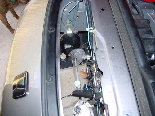

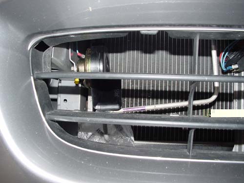

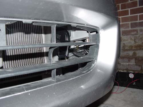

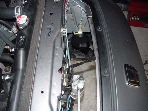

I installed Fiamms but not the air horns.
No need to remove the front bumper. You can remove the bottom covers and the upper air guard if you want.
As mentioned above, the Fiamm wiring diagram suggests that the metal chassis of the horn is ground. This is not the case. You must run a short wire from one of the terminals to the body of the car for ground.
