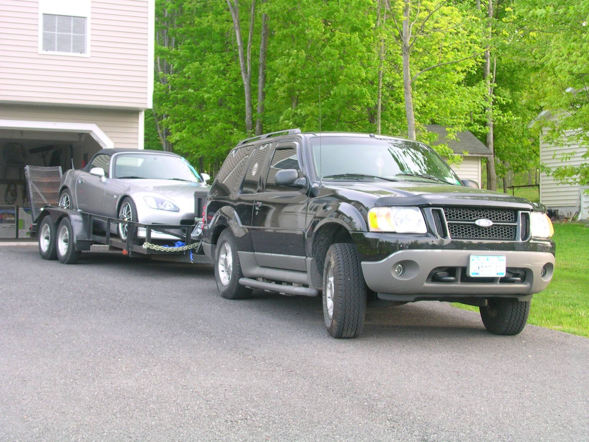

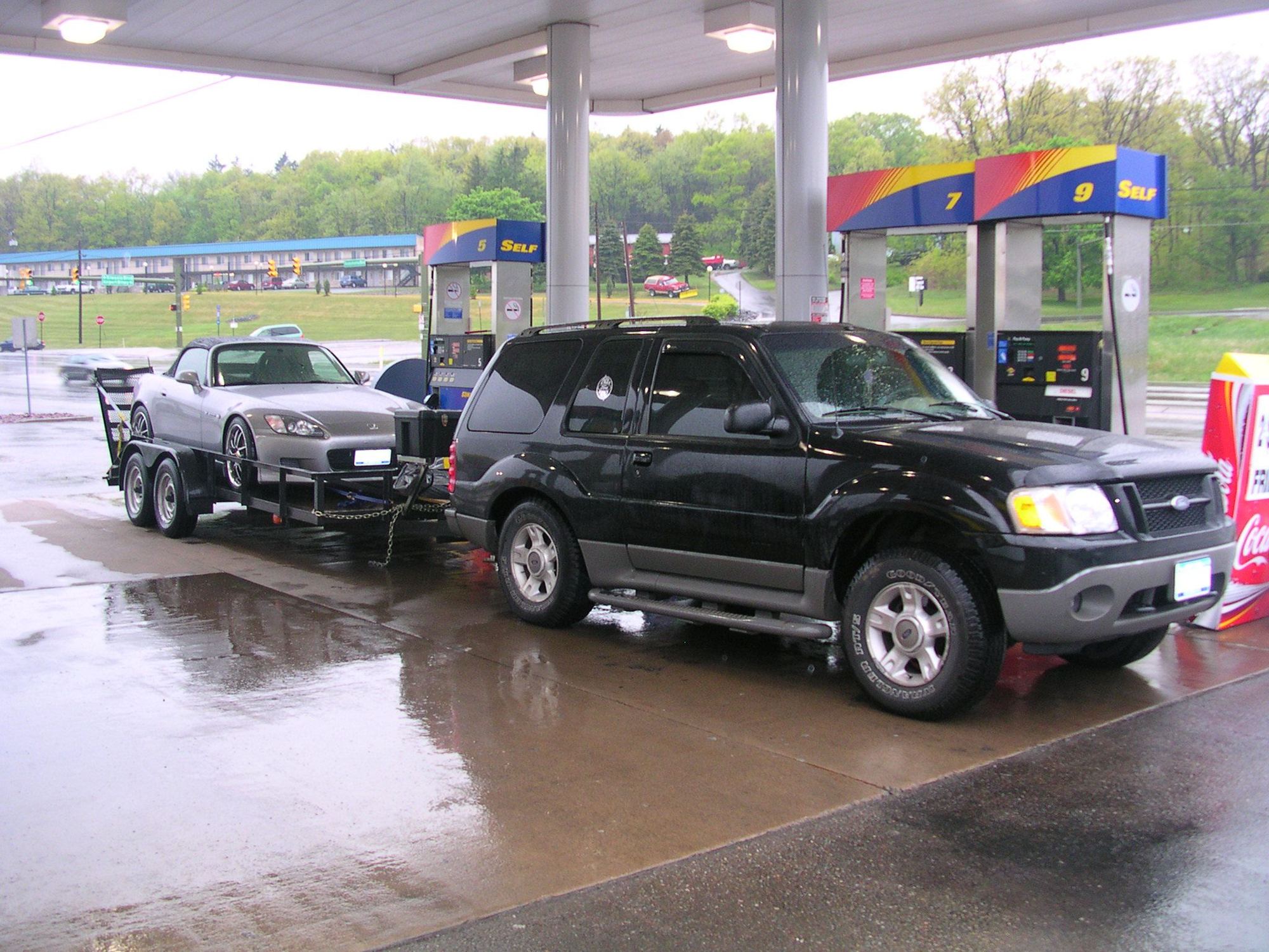

I trailered mine from NY to NC with an Exploder with no problems. And that thing only has a 4.0 V-6.

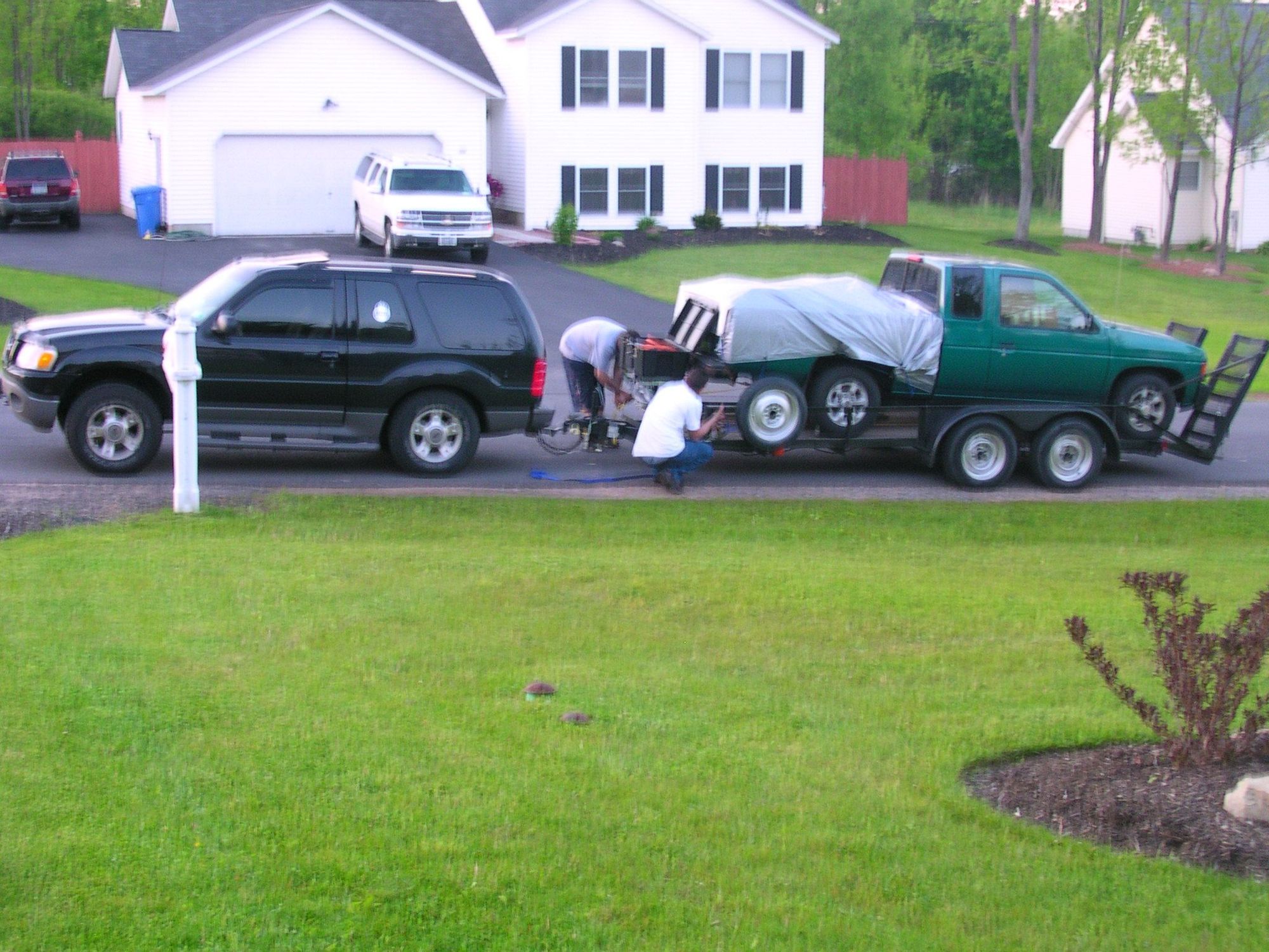

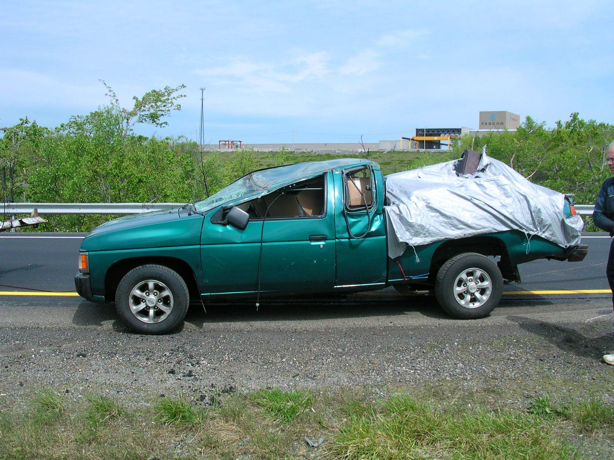

Wasn't so lucky the week after with my friend driving my beater down. Everything worked out in the end though. And we were only scared $hitle$$ and not hurt.

OMG rajun asian! I'm surprised the S didn't have the same fate as the pick up - the explorer is NOT a good towing option for that trailer and S2000.

rajun asian - just looking at the attitude of your Explorer with the green pickup on the trailer makes me cringe. I'm glad that you were not hurt.

Whooa, what happened?

[Crystal Ball] An Explorer was used to tow a trailer over its weight rating. Excessive tongue weight caused a light front end and overweighted rear springs. While towing, the trailer started swaying and the tow vehicle was unable to control the sway. The trailer and load flipped over.[/Crystal Ball]

Of course a 1/2 ton can get the trailer moving, but that is not the important part. The most important aspect of trailering is STOPPING!!!!!! The 1/2 ton w/o towing package may not have adequate brakes. You need to look into that. There is something called a heavy half, that is a half ton with a towing and brake package upgrade.
As for the Explorer, no surprise it was able to get the trailer moving, but look what happened when it couldnt contol it. Brakes & wheelbase are what you need to think of, the wheelbase should be fine with a full size truck.
We tow a horse trailer with a no-frills Chevy 2500 work truck. It is 11 years old and plenty of newer 150's and 1500's have much more powerful engines. But, they have nothing when it comes to the stopping power of the 2500. Also, we have a trailer brake that adds signifant stability to the load. It is probably not something you will find on a regular half ton.
