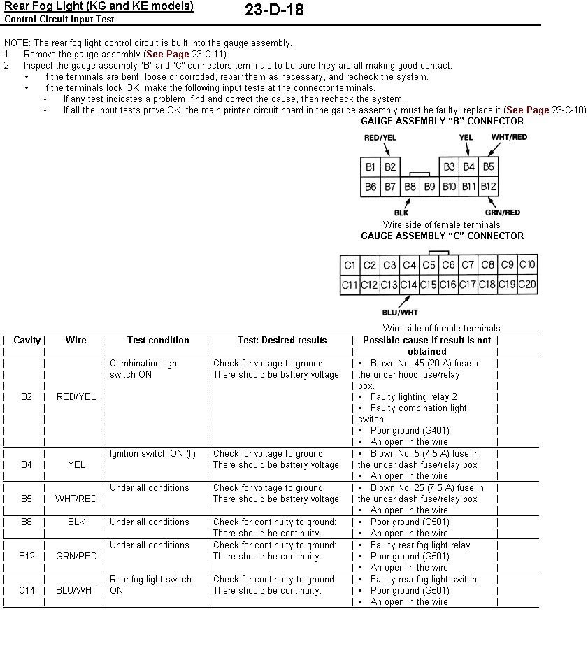

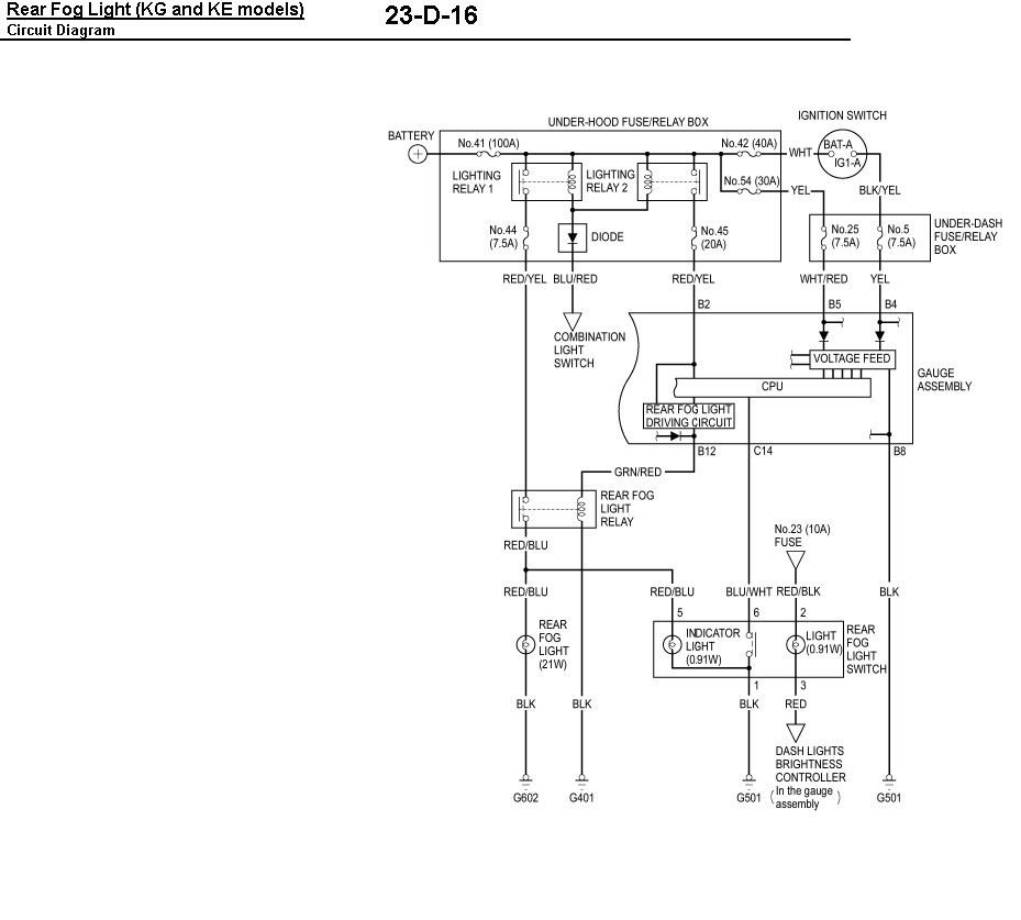

I've got a diagram of it, I'll post in a sec, the wife wants me to get dressed... somthing about a Mary Kay thing and me being naked...

If I read those diagrams correctly, there seems to be numerous colored wires for this assembly - yes?
I have only the one black wire that does not have a home.
...side note.....that fog lamp is in a strange location. Looks like it is centered between the exhaust tips in the rear vallance. What good does that do down there? We call fog lights the low-mounted FRONT facing lights, not in the rear. Not sure what purpose that would serve.
Anyway, still working the UK forum to see if they have the answer.
More to come....

Could be a grounding wire for the fog harness.
I beleive the rear fog for the UK is actually a good idea if you live in an area that actually gets dense fog, when you come up on a vehicle from the rear in dense fog, they are hard to see. I think it's design is intended for other drivers on the road, not the S2000 driver (like daytime running lights) to see since the rear fog is red. And yes, it's in the valance.
