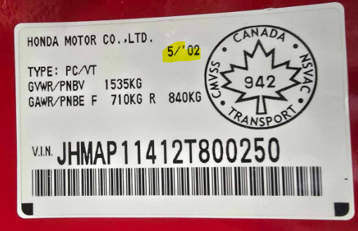

Originally Posted by twohoos
That engine # is for a Canada model. The highest '02 Canada VIN is 320, so you're right on the edge. Look for the production date on the big white sticker on the driver's doorframe (it has a maple leaf on it).
THIS is what I was looking for!!!! Thank you!! The Canadian production was jokingly low...so my thought would be a low engine/VIN number would be completely out of context with a USA engine/vin.
A few years back I passed on another 2002 with low mileage...because the vin was low. I was looking for something in the mid 5000's thinking it followed suite with the USA cars. Darn lol.
If it's 5/'02 or later, you're OK. The updated engines were used starting in mid-April.
I had the dealer send me the door jamb decal...build date is May 2022! So looks like this one would be good to go with the updated banjo bolt, correct?
