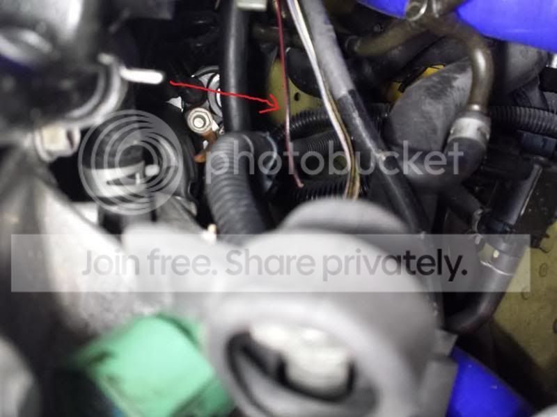

So I recently picked up an S2000 with no AC. Of course seller said I just needed to compressor, condenser, hoses and I was good to go. So I purchased the compressor and started the install. After getting the compressor bolted in, I began to look for the power connector and could not find it for the life of me. Turns out the original owner cut the plug(to save 0.005lbs?). I peeled someone the black tape to see if I can splice another connector on. However, I can only find one wire (I think its positive). The negative wire appears to be missing.
Can someone shine some light to how I can fix this? Perhaps an alternative way to power the compressor? I'm not that tech savvy to replace the entire harness on my own.

Could you do that for me? I can't seem to find a reference picture up close.
From the compressor side, the connector has a black and red wire. I assume the harness side should be the same?

That wire is the 12v for the compressor clutch
It only has one wire. It gets ground through the compressor body
