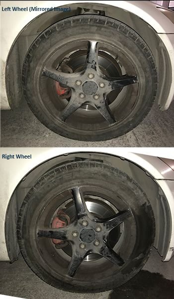

My mechanic has checked to see for any bent parts but he couldn't see any obviously bent parts, however he did say that when he was working on it he found the bolts of the subframe swapped on one side (the short bolt was instead of the longer bolt on one side) which tells me that at one point the sub frame was removed and installed back incorrectly. In addition my right wheel seems to be a bit further back in the wheel well than the one on the left hand side, maybe 1cm or so, however the alignment report is showing only 0.1 inch difference in setback.

Take this with a grain of salt, but i had/have similar issues. The knuckles are fairly easy bent and can throw alignment specs off...i learned this through other s2ki posts. There is no method for measuring a kunckle as far as i know. People just start swapping parts until they figure it out.
one other option would be to loosen the front subframe bolts and shift the subframe over...or just put in a spoon rigid collar set so the subframe is in the correct position.

usually a bent part would effect more than a single adjustment, I would say its a lot more likely that the top of the caster adjuster is not lined up properly with the lower part on that side, and or the bushing portion isnt sitting properly
