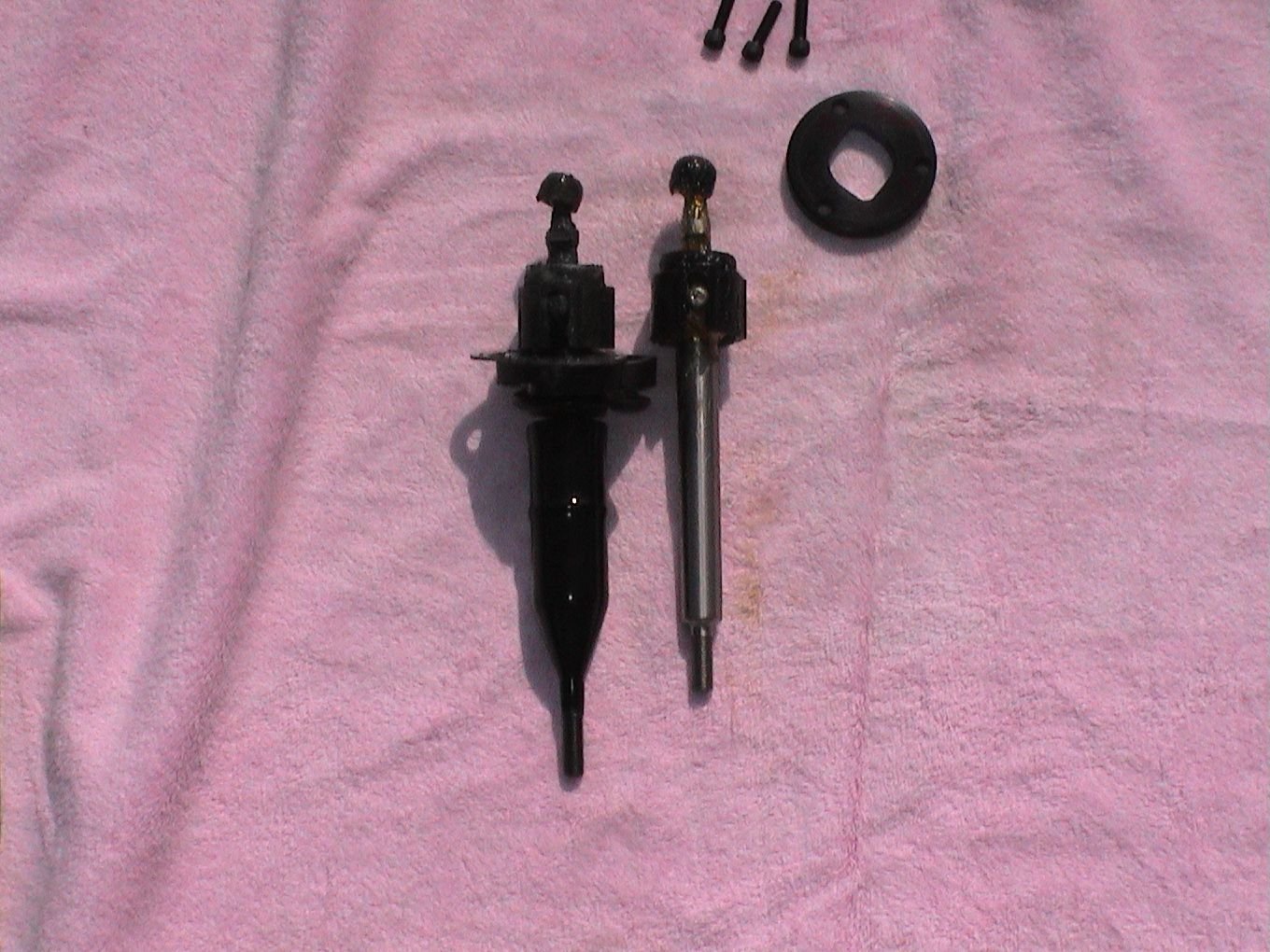

Originally Posted by billman250,Mar 20 2006, 08:19 PM
It's solid steel, and vibrates like hell. If anybody knew how that shifter was designed, they would not buy one.
It's not even a true short throw (higher fulcrum point) shifter like the C's. It's nothing but a shorter shifter on top and it's solid. You could have one made for 40 bucks.
Have you actually measured one? Mine appeared to have increased throw as well as shortened shaft.
You can see the pins lined up here and the reach on the RP is greater (higher fulcrum point.)
