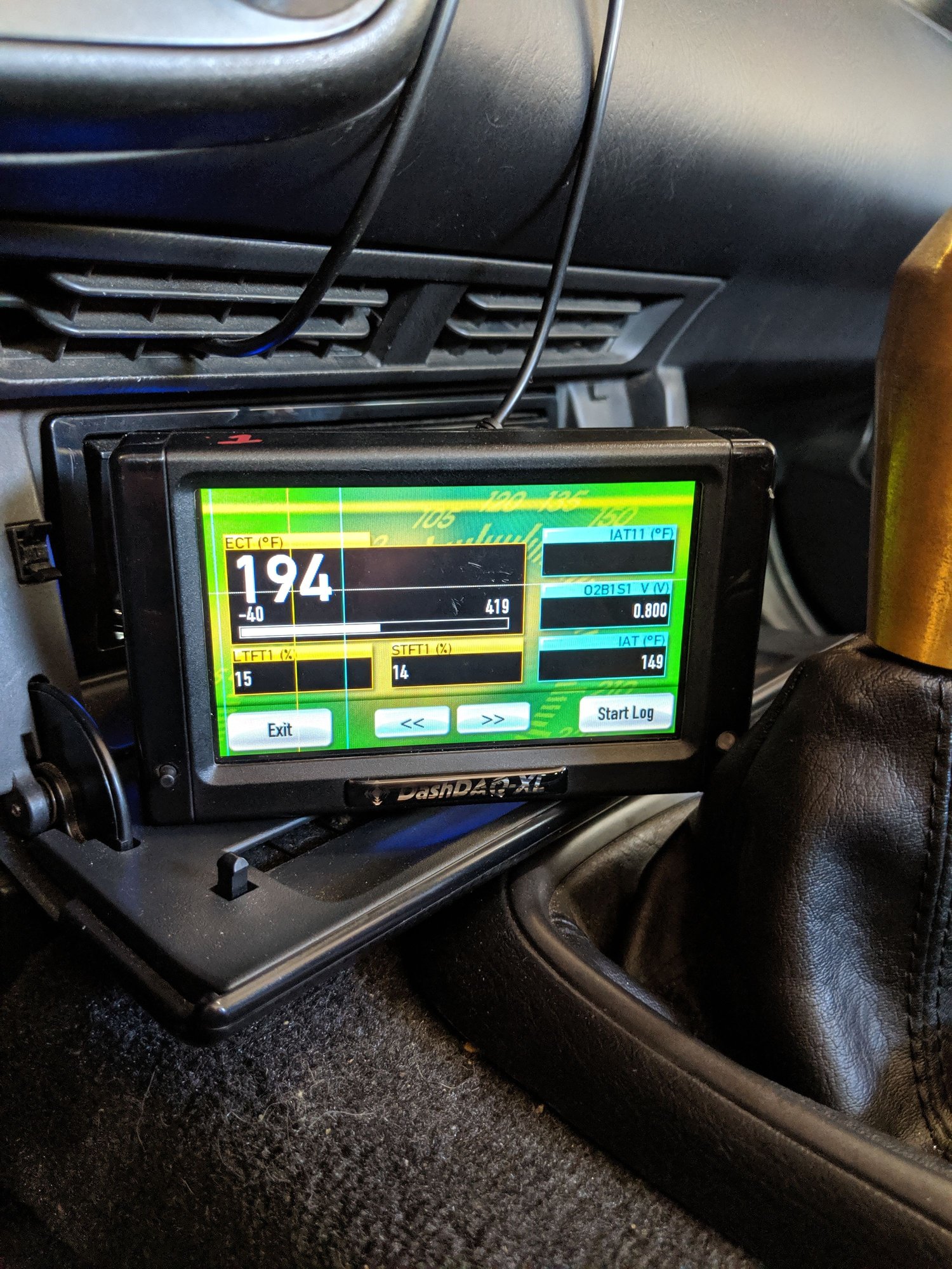

Welp. I got out the propane torch....and found nothing. I sprayed it on all the areas that I thought could have any kind of possibility of leaking at all. IAT sensor replaced without any changes. I performed an idle relearn and now it seems to never stall, but the RPM's do get very low.
I guess onto the "real" issue here is the fuel trims are kind of out of control at idle sometimes. I'm a little skeptical of this OBD reader I have, so I ordered a new bluetooth one off of Amazon; that will be here tomorrow and maybe I can confirm some of these things.
I took a data log, which is attached.

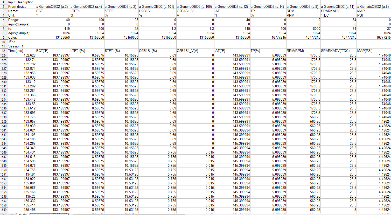

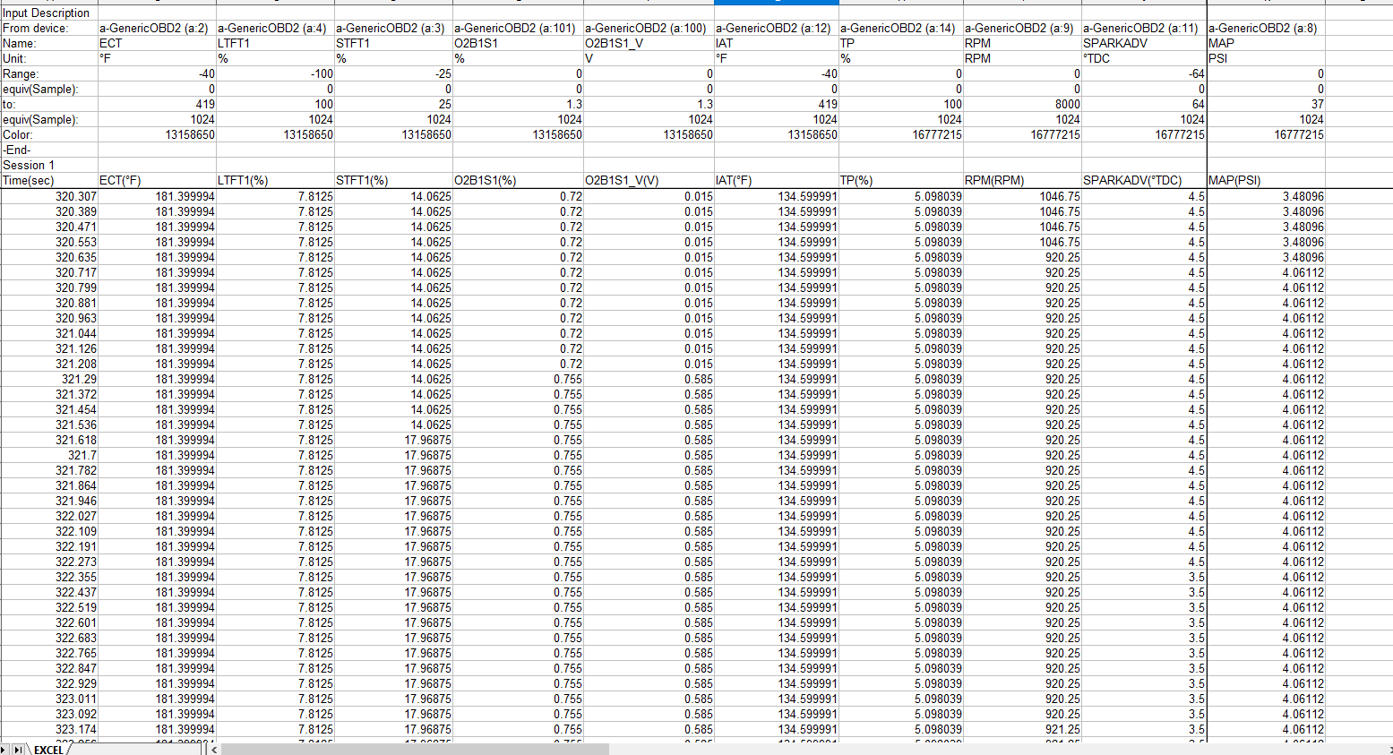

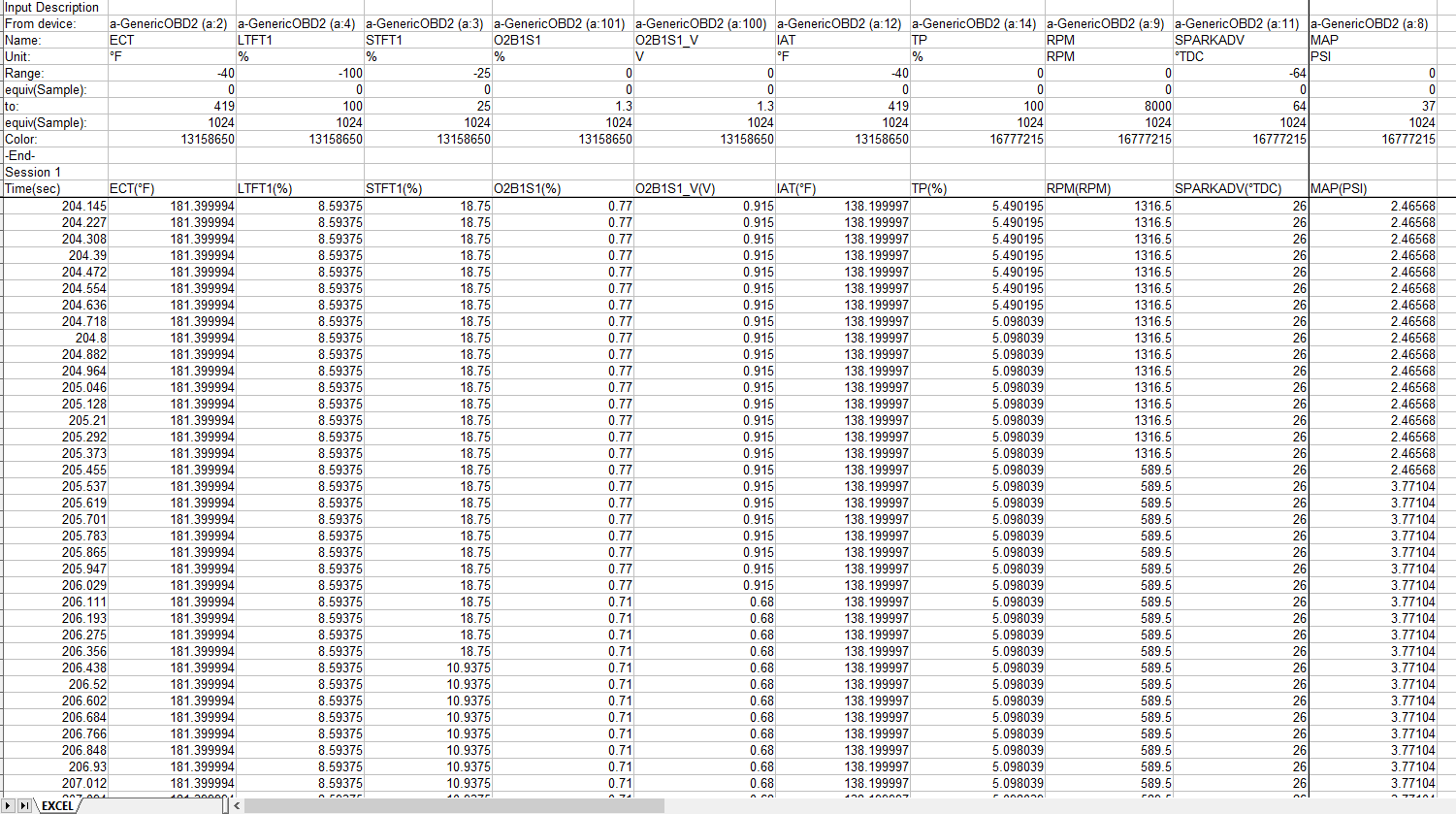

A few screenshots. After reviewing the data, I basically found at idle it is adding fuel (+ STFT) that eventually just maxes the LTFT out if I leave it there. When I go drive the car, it evens it all out and I usually have a LTFT in the low single digits by the end of the 20 minute cruise. So, still that is telling me vacuum leak. I also noticed this parameter "O2B1S1" in a "%" format. On all the other cars I've owned, they have had wideband O2's, so it was easy to tell AFR. I'm not sure if this % means Lambda or not. If it means Lambda though, the car is running extremely rich all the time. Which makes no sense either, so I'm going to vote a no on this.
Anyway, here are some screenshots for people that don't want to open the file:

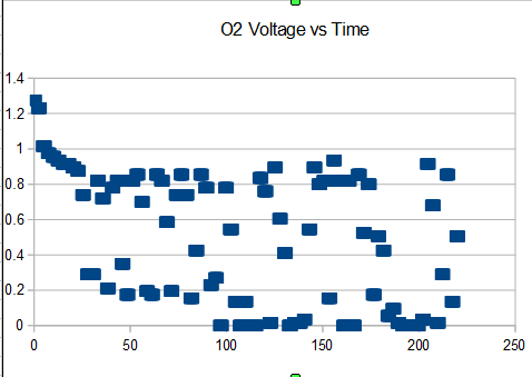

Edit: I know this makes it hard with the data acq being so slow as well.....but here's also OBD O2 Voltage vs Time. Keep in mind I did go drive the car during this log. Is seeing 0V normal?

If you think your car is running really rich based on that O2B1 % reading then wouldn't it be best to install an AEM wideband just to see what the AFR reading really is while idling, cruising and WOT?
How many vacuum leaks could there possibly be? Could an injector or two need sonic cleaning?
