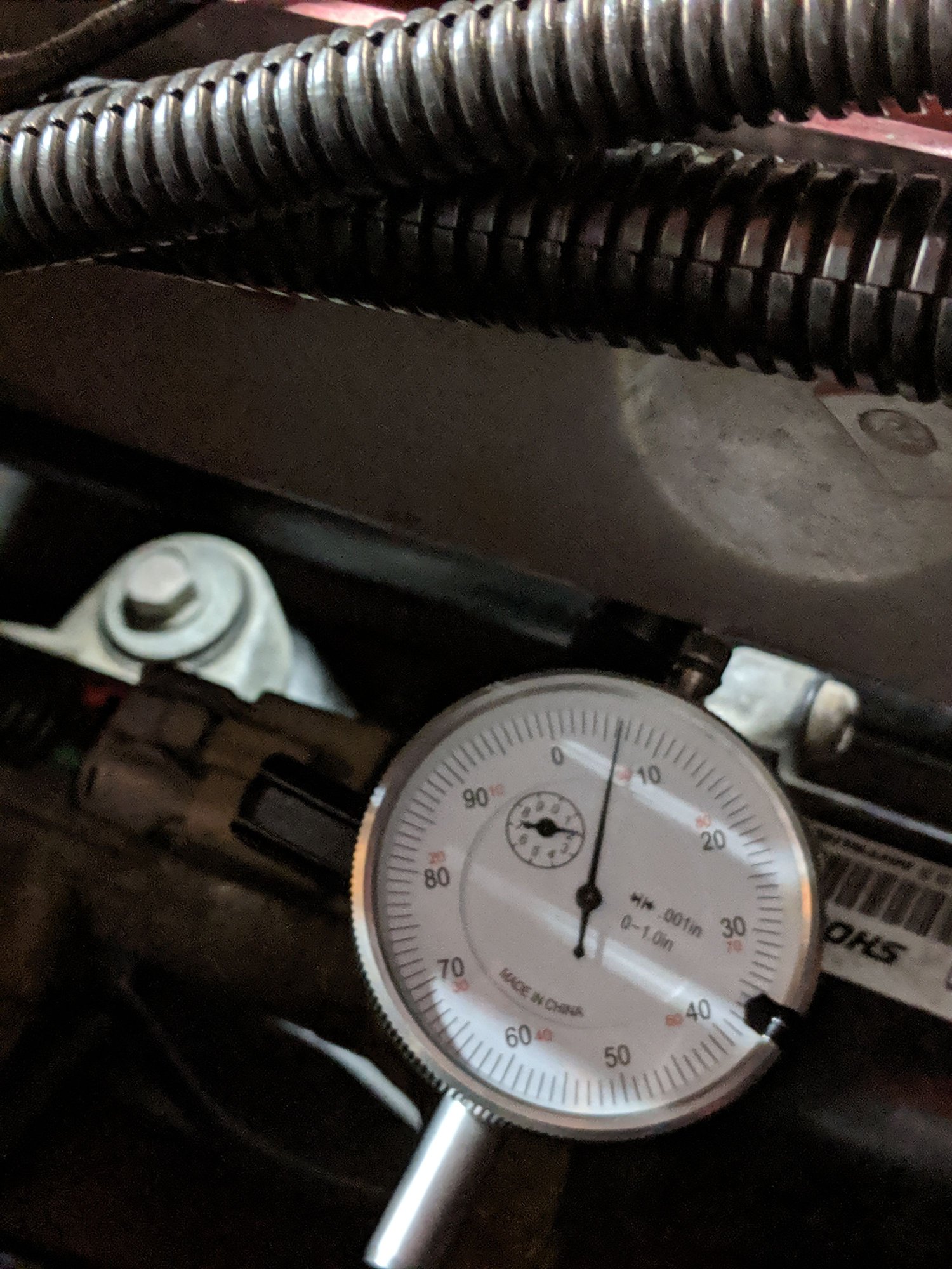

The plot thickens....it seems the engine will only stall if I let it be in fuel cut off mode (aka not spraying fuel on a coast down). This ONLY happens after the car has been driven once during the day. For example this evening I drove home after letting my car sit for 8 hours at a friend's house.....as soon as I push in the clutch while it's in fuel cut off mode BAM stall. But if I don't let it be in fuel cut off, it will never stall. Interestingly enough on the way there it didn't exhibit this condition. Makes a guy wonder.....
It's pointing to something fuel related. Since the only components left are fuel pump and regulator....guess what's happening next.

This might be a long shot but have you checked your crankshaft end play?
I have not physically checked the endplay but I did check the vtec solenoid for debris....nothing there. If it got this bad you'd figure it would be littered with metal if that's what it was.

It's easy to do so I would check it either way, your symptoms are really weird.
Checked the end play, .006-.007" seems good to go, checked it multiple times. Thank goodness.
