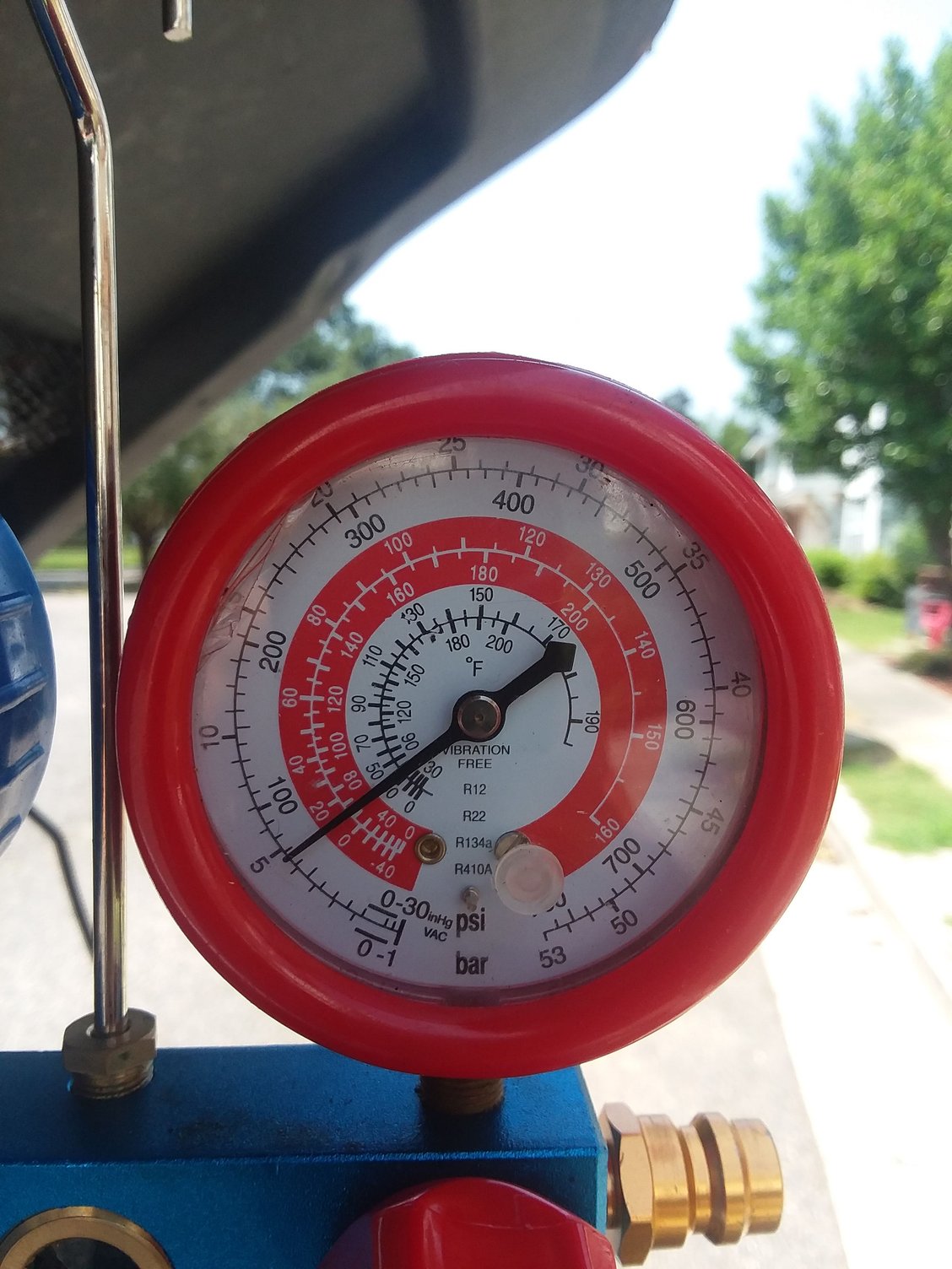

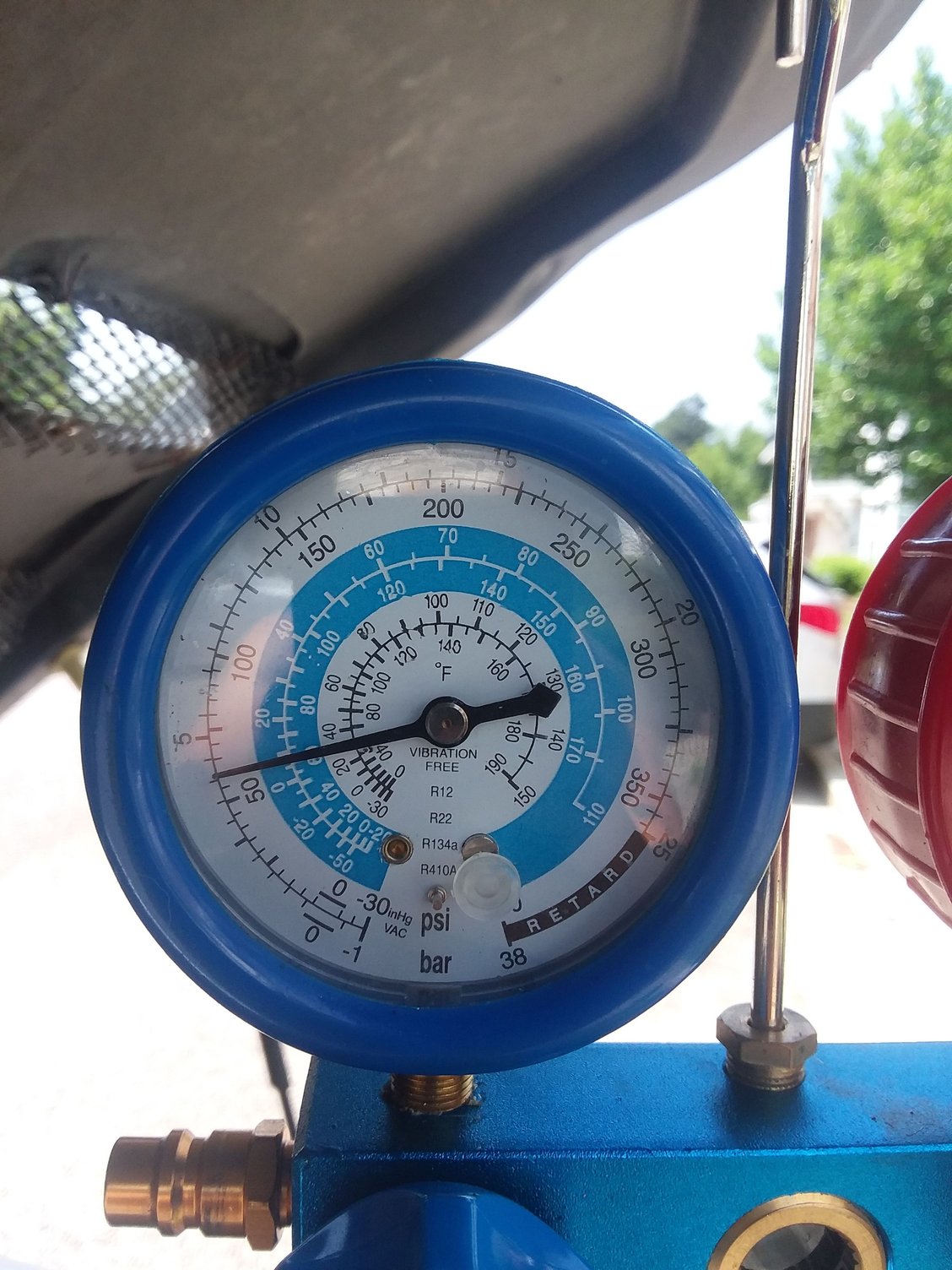

just an update: pulled the pressure switch off the evaporator the other day with the car running, the clutch disengages instantly. plug it back in and it engages again. so clutch is good. did take some more readings. tried to add some more freon but the low side pressure was still too high. definitely looking like bleed through inside the compressor. reed valves or whatever one way mechanism is failing. let out 40psi on the low side with the car off and it showed the loss of psi on the high side. so for sure seems like a compressor failure. going to order a new compressor and drier. should i do anything with the expansion valve or not? going to probably blow the system back with the lines removed. anything else on these?

so update: today i got a chance to pull the system down for a few hours. removed both schrader valves to inspect the line for obvious debris and didn't see anything but some residual PAG oil in the bottom of the lines. pulled the vacuum and held the pull for around 2 hours and turned off the pump for another 2 hours and everything held up tight. when i put the can onto the center fill line. i purged it at the top near the fill manifold to get as much air out as possible. then opened the low side to weigh in the gas and it only took a couple ounces. reached the pressure you see on the low side. started it up to ensure it wasn't some kind of vapor lock in the system and nope. so i'm going to be buying a compressor and drier before i take her out of town in sept. just odd since it happened randomly one day and it's dead quiet. no rattling or squealing. just, doesn't work. anyhow i'll keep anyone updated who's having similar issues or is just curious. appreciate the input. cheers.

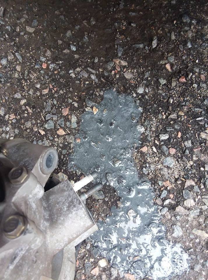

well got everything replaced put freon back in after a 2 hour pull down AFTER a flush. looks like everything is working great. the pressures are still low and i weighed in about 12.2 oz roughly before the bottom fell out. but i'll finish it off after the weather clears up. old compressor was NOT working at all. tons of contamination but there was absolutely ZERO noise. so word to the wise, pay attention to your gauges. picture shows the "aluminum oil" that came out after i put it on the ground. plenty more next to my head lol. pull the bottom bracket (3 12mm BOLTS) to let her slide right out the bottom. really easy task actually. glad i could do it. hope this helps someone in the future.
