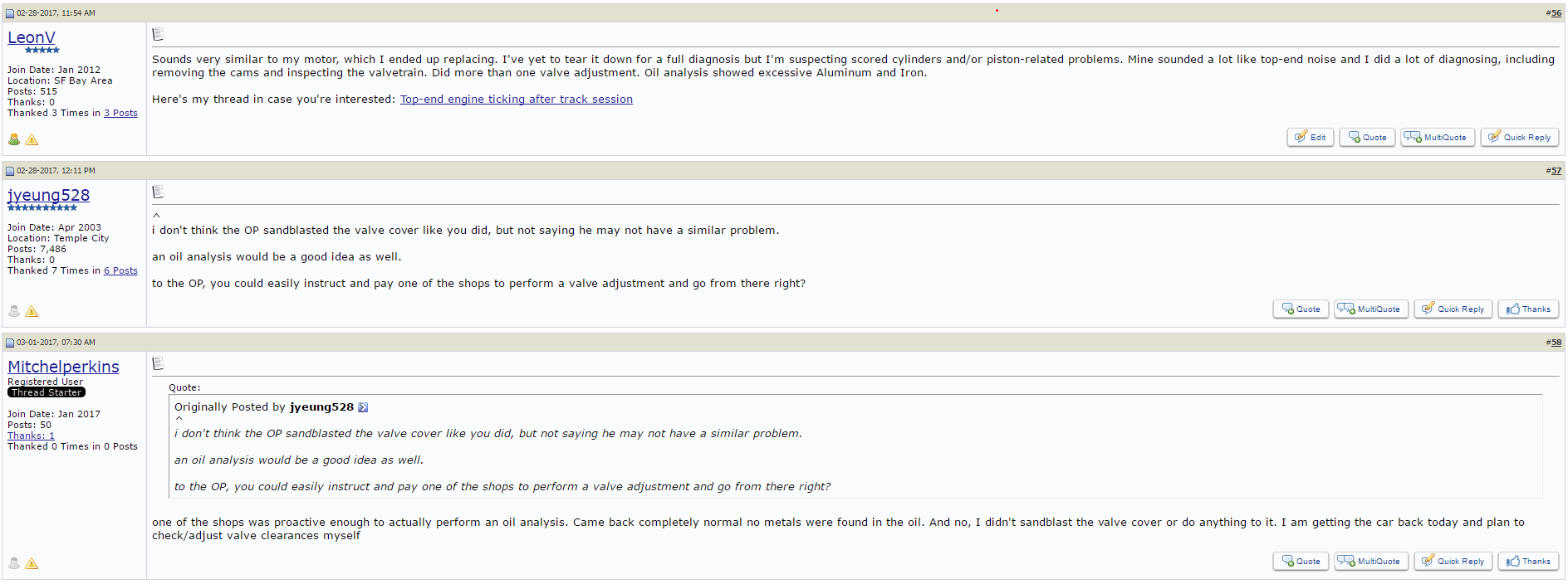

Sounds like my guess was not too far off, considering that there wasn't actually an oil analysis performed...

so the oil analysis that was performed was a mechanic at the shop using his eyeballs to look for metal in the oil. unfortunately this is not actually an oil analysis.
so, there is the possibility that an actual oil analysis shows some damage.
sorry OP, keep us updated if you breathe new life into this car.

they claimed they had the proper machinery to test the oil, something about ultraviolet light on it I believe but maybe they were bullshitting me, I paid $250 for that so they better not be. I am very burned out on the car, it is a poor investment that will spend a while sitting.

Holly crap dude, that is a massive load of BS!! I send my oil to blackstone and for $25 I get an actual report with the wear metals in it. I wouldn't trust a thing that that shop has told you and I would never go back
