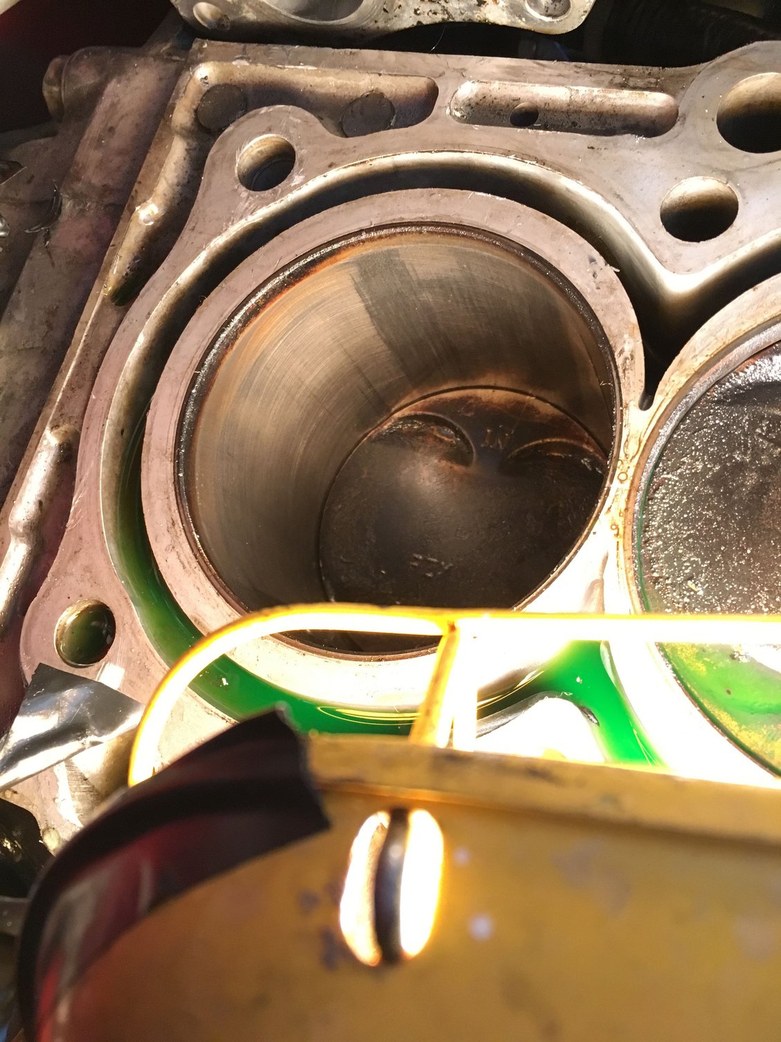

This is cylinder 4. None of the cylinders show any major scoring and feel very smooth to touch, but this wear line on cylinder 4 looks like it could possibly be part of what was causing that noise.
