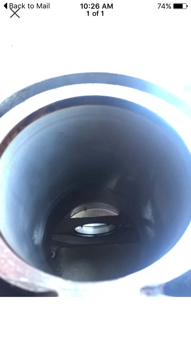

That block is no good. Some idiot took a screwdriver to the piston and chipped the walls. Ridiculous way to kill an engine block.

Whoa! Yeah never mind, but yeah F22 and F20 blocks are essentially interchangeable. Who would ruin a block like that, shame.

How does anyone know what condition a block or other used parts are in. Someone who knows what they are doing need to inspect part. In person. Can't tell anything by looking at pictures. For the most part.
Exactly. Which is why I won't be buying any critical parts without seeing them in person.
