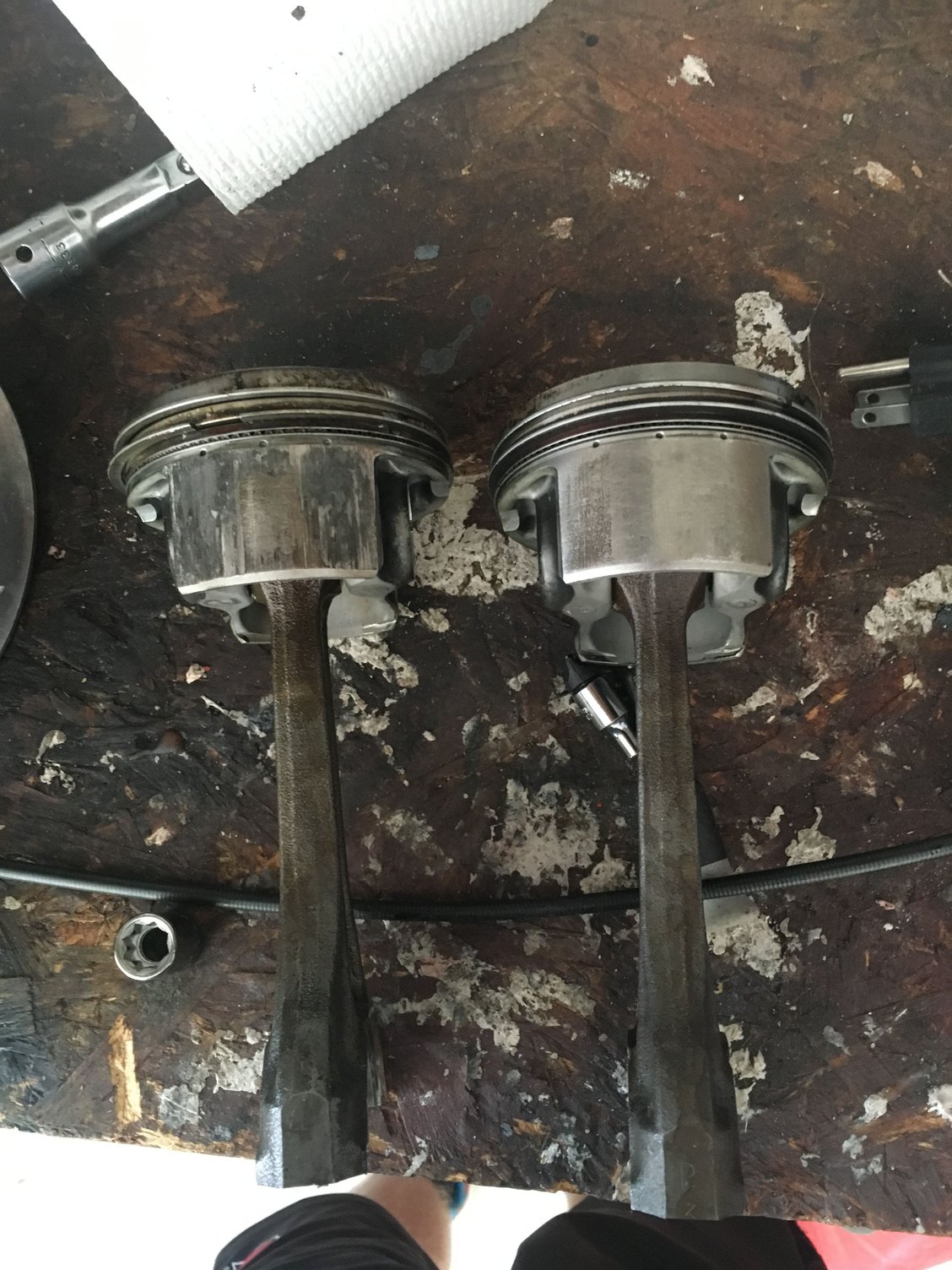

I got a slick idea and did some math and found that a 3/8 12-point socket is roughly 9.5mm... Considering how loose the 10mm fit on the bolts I figured hey maybe I could hammer it on... And it wasn't easy, but it worked. I have, without a doubt, found the source of the noise. The picture below is Pistons 4 and 3 side by side. I'm sure everyone knows which one belonged to cylinder 4..
I'll admit I have no clue.

Likes: 632
The one with the scored skirt of course. How are the crank journals looking?
the crank looks to be in great shape, another discovery though that I forgot to take pictures of is that the bottom half of the bearings on cylinder #4 had a couple 'nicks' in them, is the best I could describe it. Very noticeable with a fingernail and looked similar to how you can nick an aluminum part of the engine during assembly/disassembly, I'd say it had about 3 or 4 small nicks on it mostly around the center area of the bearing. This was only in cylinder 4, no other signs of any bearing problems in any other cylinders, I will take pictures when I get a chance and add them.
i went ahead and disassembled the whole timing assembly(plan to replace chains and guides while I am so deep in the engine anyways) so the engine spins very freely now and the crank seems to be in great shape, a couple of the shops I've talked to claim I'd be crazy to not remove and machine the crank, but it doesn't appear to have anything wrong with it and it's quite possible the last shop had already machined it then... what do you think is best?
