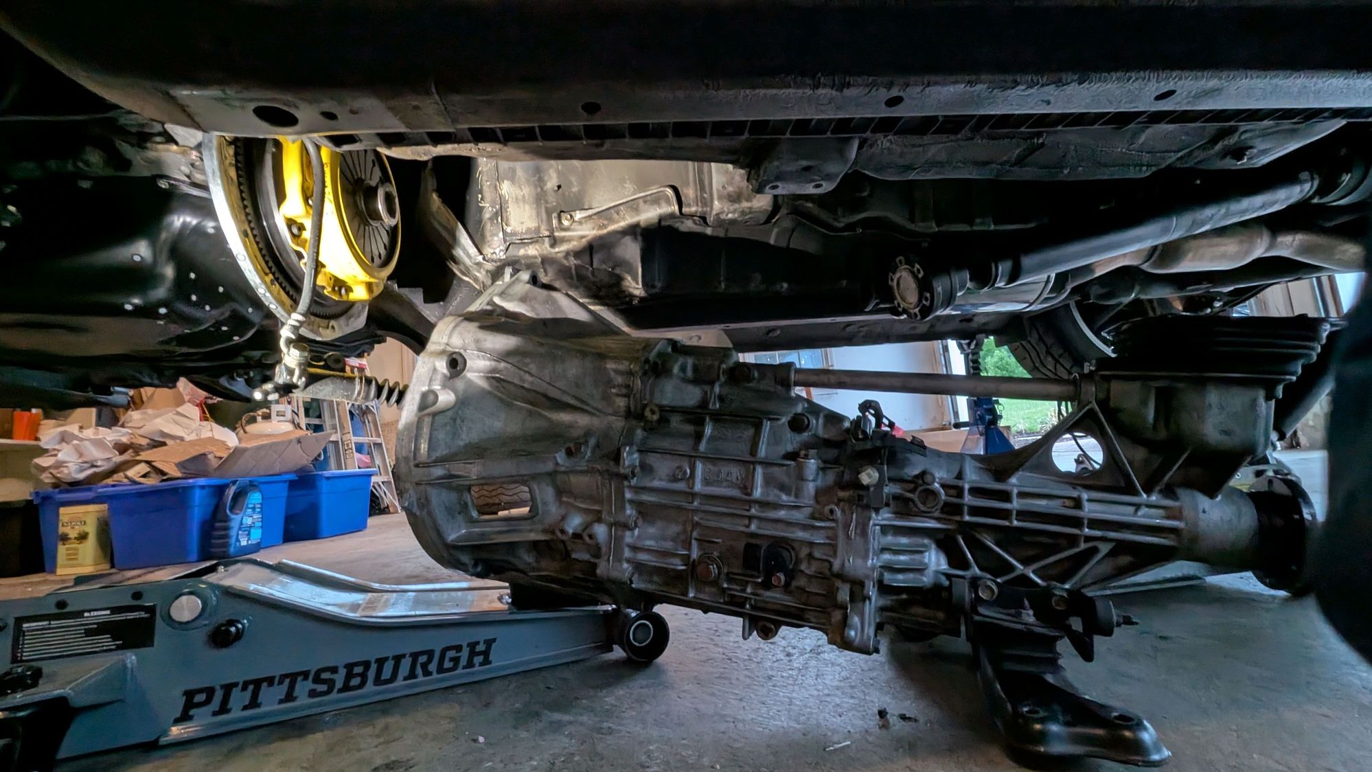

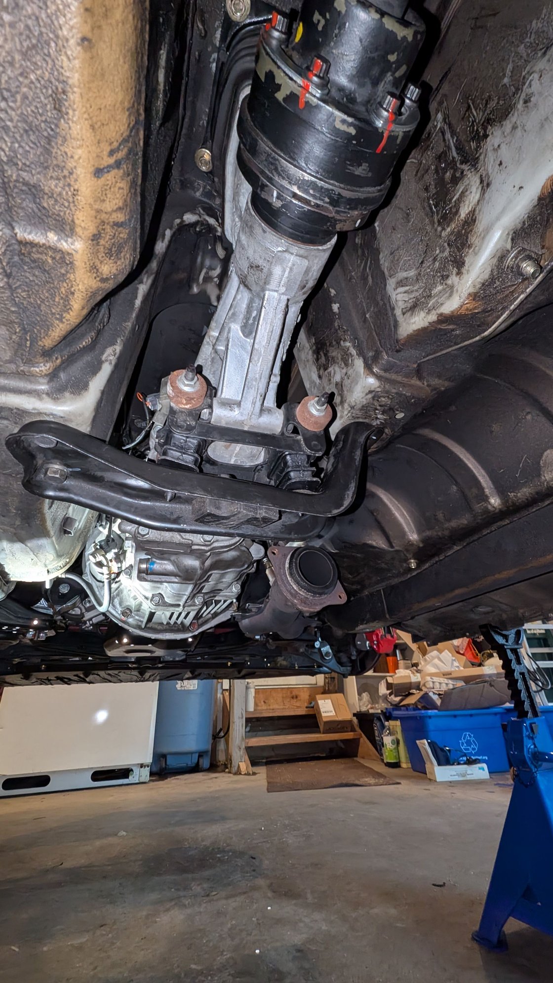

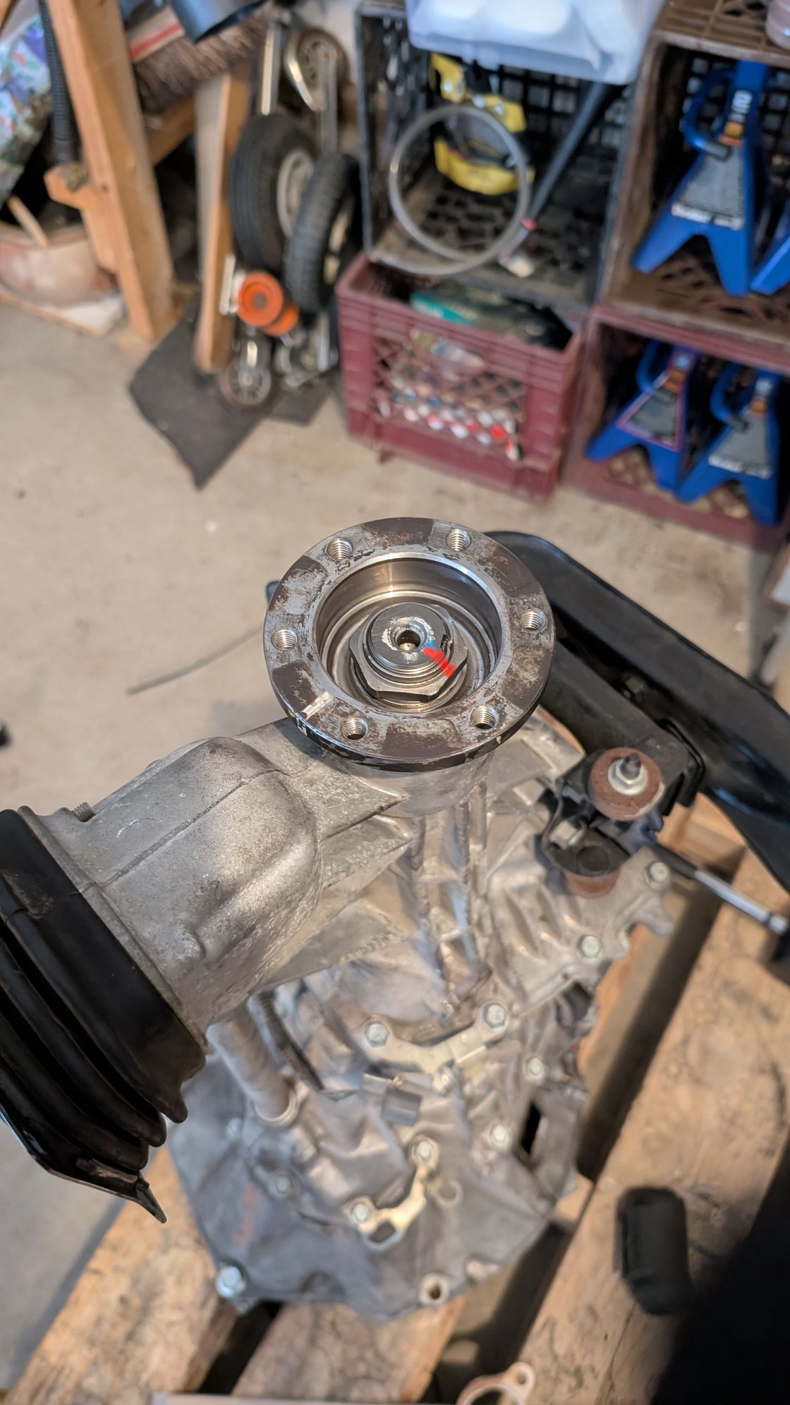

So I dropped the old transmission this past weekend and sure enough something is bad in the transmission. I sourced an AP2 transmission, swapped the AP1 driveshaft flange over and installed it.
Issues are gone, but I want to tear down my AP1 trans to see if I can't figure out what happened to it and rebuild it.
Pics below of old trans dropped and installing the new AP2 trans.

Remove the large Allen bolt on the bell housing, you can see inside the transmission through there and there's a magnet below it that will pick up any chunks.
