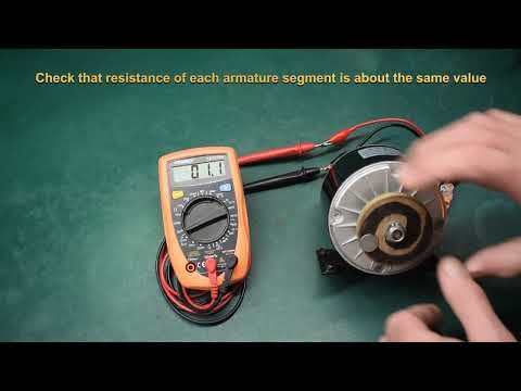

The problem was definitely the blower motor. I took it out and did a continuity test similar shown in this video here. I just used the continuity setting on my voltmeter instead of resistance as shown in the video and the majority of the time when spinning my fan around it didn't have continuity between the two motor terminals.
