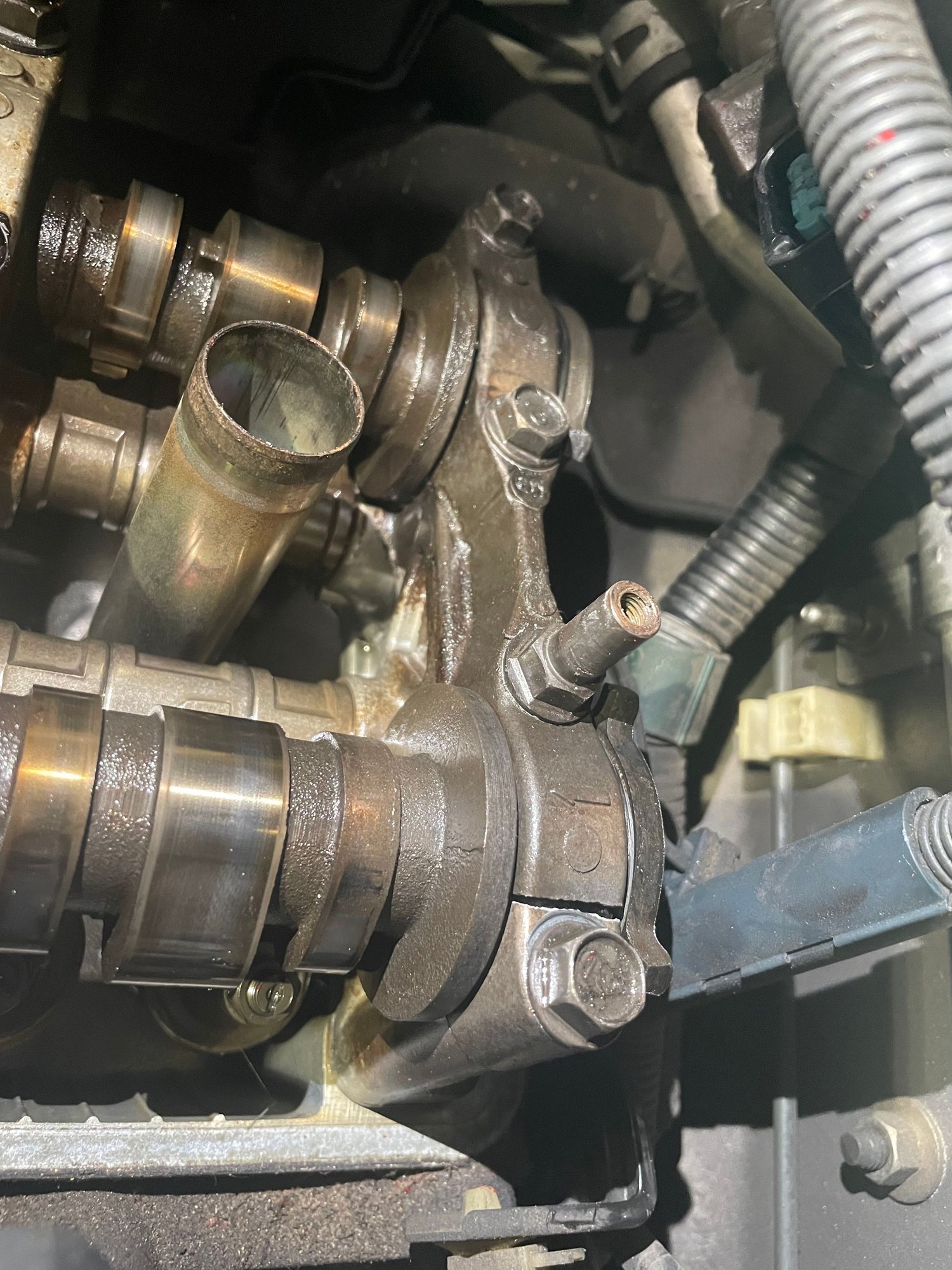

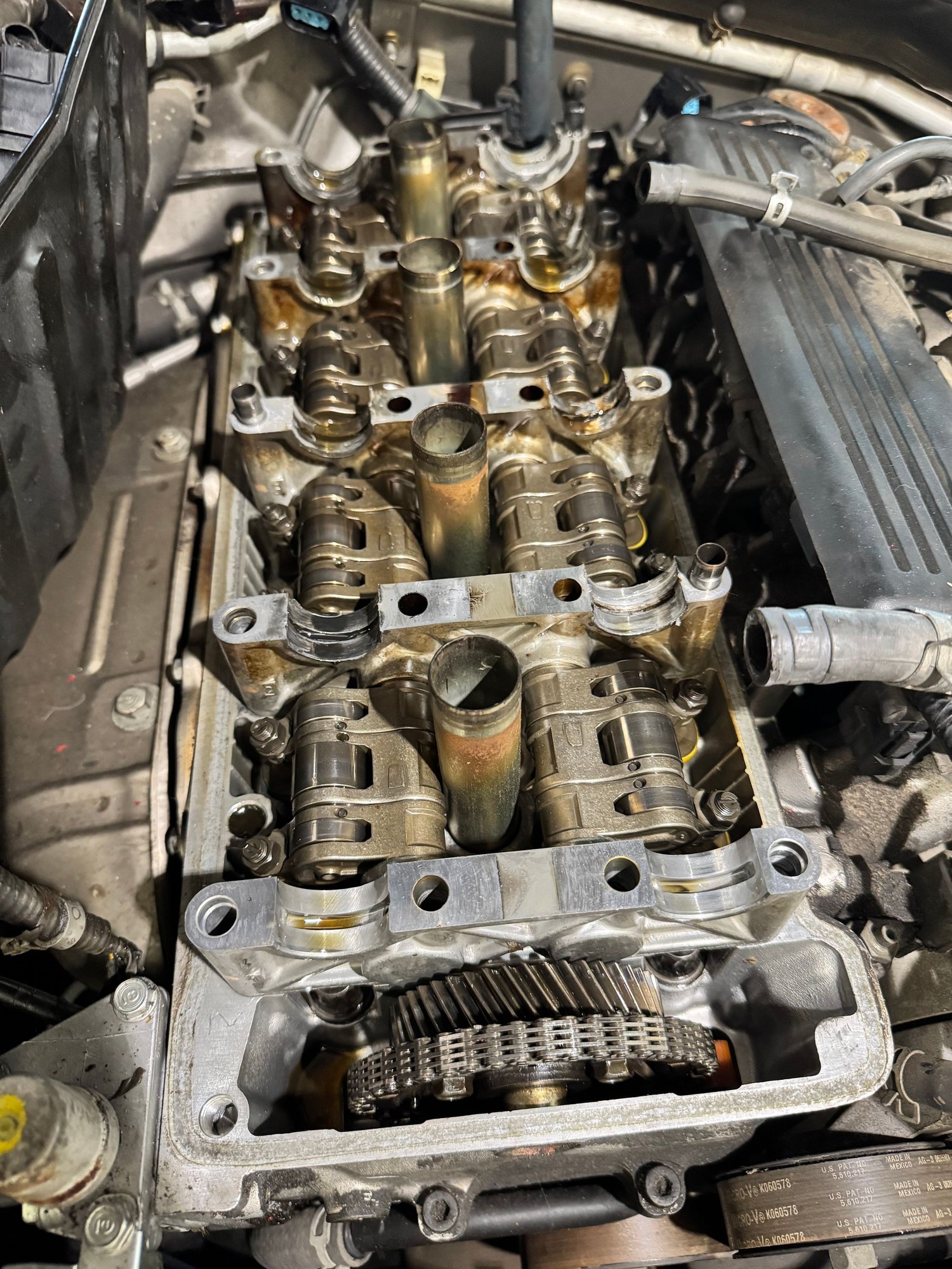

Yr2000 number 5 cam cap broken.
150k miles.
Where from here guys? Order matching set and replace? Anything else to do while I’m at it?
Thank you in advance for any help. Very appreciated!

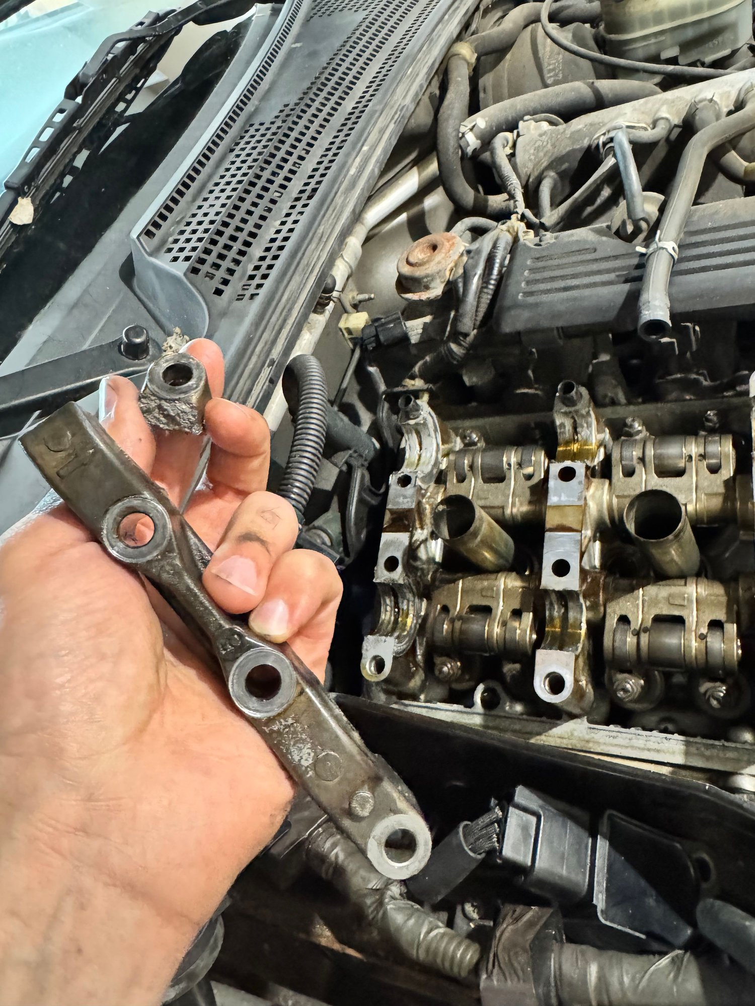

Cam cap 5 broken. That was the reason sensor was worn.

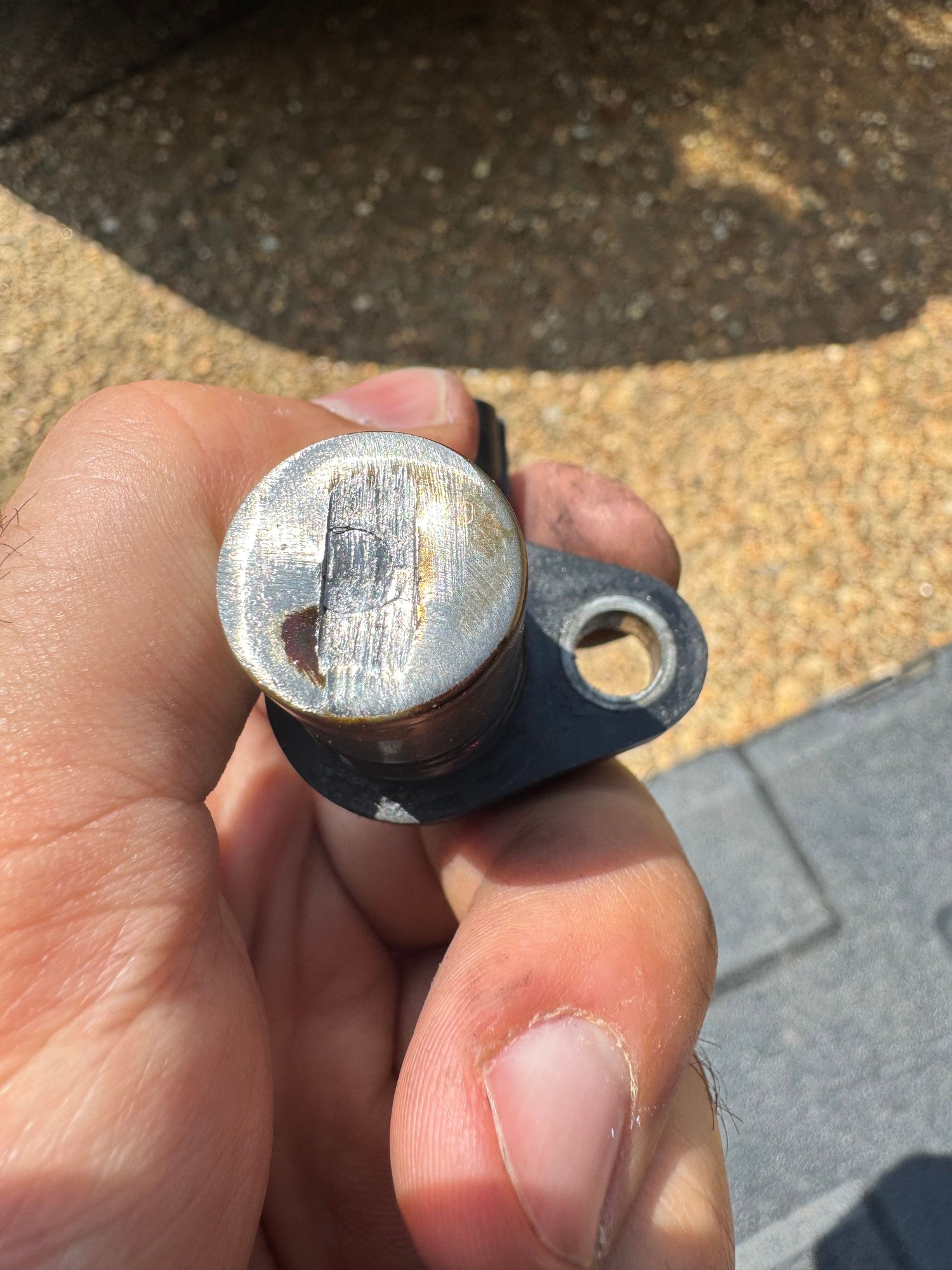

Sensor B with worn groove.

Yeah, you'll want to buy the whole cam tower set.
Check the cam for wear too.

I've never seen much information about these kinds of failures, but you want to explore the potential cause as much as you can. Finding replacements is hard, you don't want it to happen again.
Maybe check the screen on the vtec solenoid and make sure it isn't plugged with any kind of debris ? causing oil starvation issues . Unless the cap was over-torqued in recent times if someone worked on the engine. just guessing.

My guess is that it was an improper torque sequence during the last tightening.

That happened from running a long period with 0 oil pressure. Note the overheating and burning of the cams.
Loose camwheel bolt is the number one cause. As soon as that bolt becomes loose, oil pressure bleeds off from the camwheel into the chain case, starving the top end.

Back off the valve adjustment screws all the way, set valve lash after tightening the cam caps. Pressure from the valve spring can put enough tension to crack a cap.

Also follow the torque sequence from the service manual, think it starts from the middle cap then alternately front/rear.
