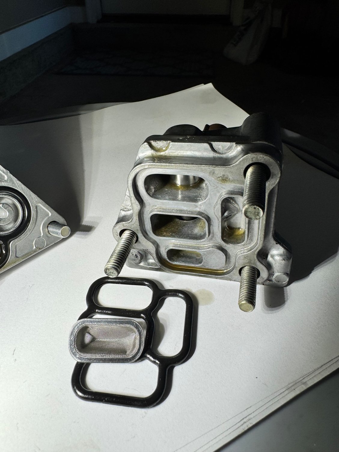

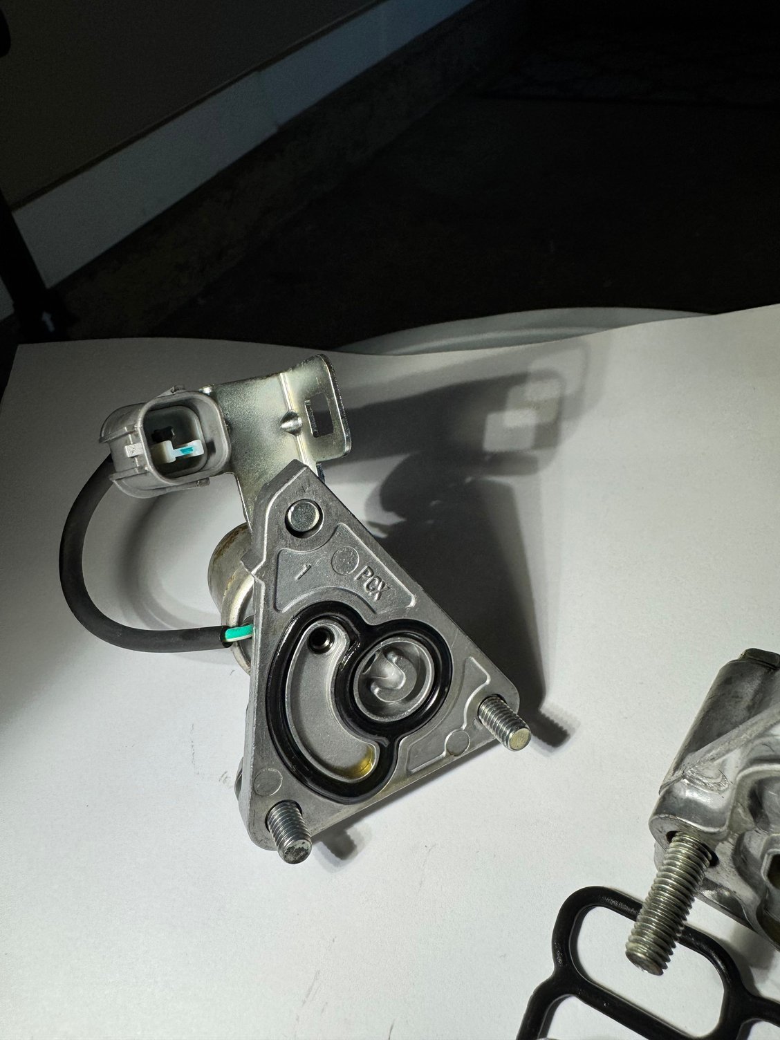

Pulled the VTEC solenoid and it seems to look good. There may have been a tiny bit of aluminum in the screen (from cam caps). Planning to replace gaskets/screen and reinstall

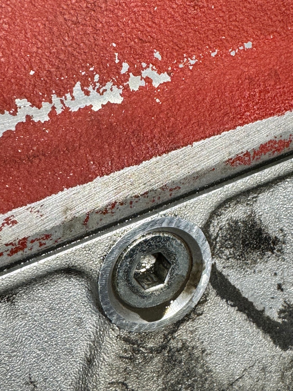

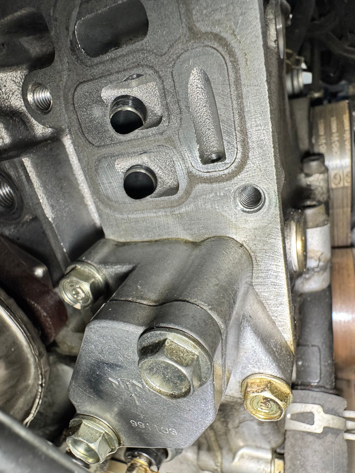

Default Cam wheel bolt leaking?
Old May 26, 2025 | 09:33 AM
  #25
windhund116's Avatar
Joined: Sep 2014
Posts: 11,397
Likes: 1,798
Originally Posted by DuncansS2k
Ugh! This video may help.
