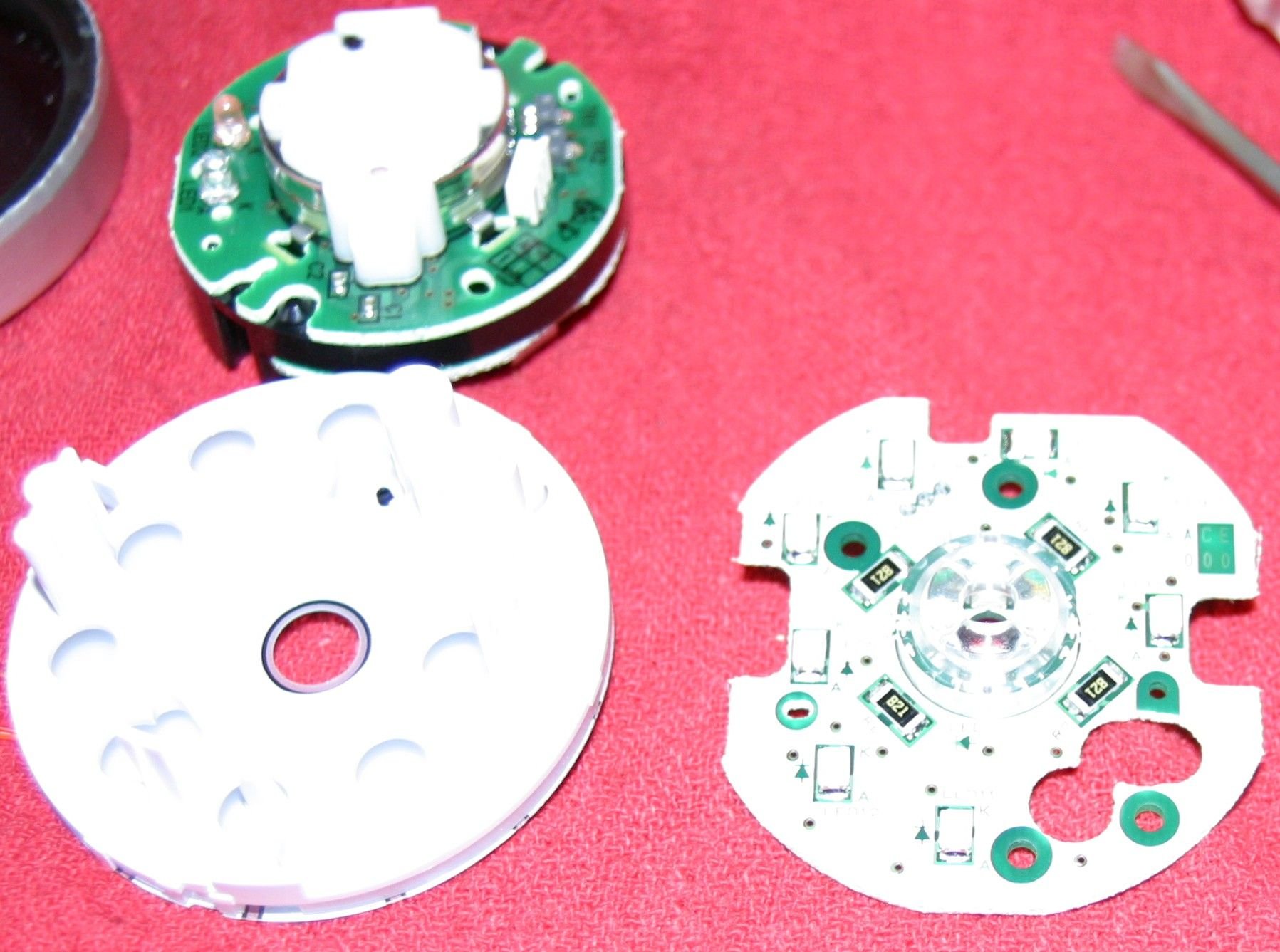

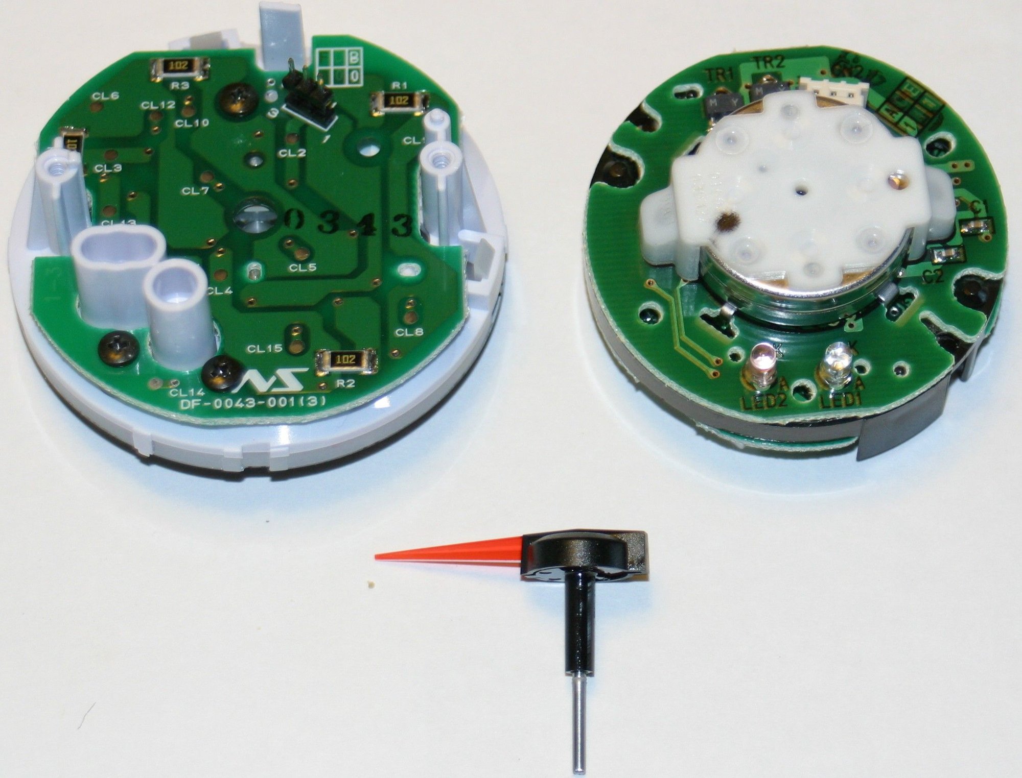

Step one: Gently pry the back of the gauge face cover that is flanged to hold it onto the gauge back casing with a small flat head screwdriver. Be very careful with this as you can damage the flange easily so that it is visible when you reassemble it. Do this on about 3/8s of the flange. Gently pull the gauge face cover off, it will take a little bit of effort as you pull the back casing off at an angle. If you want, you can bend the entire flange to make this easier but it's not necessary. You may want to cover the screwdriver head with tape to avoid scraping the flange.
Step two: Remove the two screws retaining the gauge back casing. Remove the gauge casing.
Step three: Remove the two black screws that are recessed in the black plastic portion of the gauge (see image above). Gently remove the dual board. This will take a bit of effort as this piece has the gauge needle attached. Be sure to pull straight back to get the needle out of the mechanism. Be careful not to bend the needles pin. Also be careful not to bend the electrical connecting ping on the board below.
Step four: Remove the three black screws on the board and gently pull it off of the gauge face. There is another set of electrical connector pins on this piece as well.
Step five: Take a blue Sharpie (or whatever color you desire) and color each of the 8 rectangular LEDs, you may want to go over them a few times to darken your color choice when they are lit.
Step six: Reassemble the gauge pieces in reverse order. I don't know the torque settings for the screws but do not overtighten the once that are in direct contact with the circuit board, you don't want to crack it. The board with the colored LEDs can only go one way onto the back of the gauge face but the board that goes on top of the LED board can go back on the wrong way. There are electrical pin connectors that must connect, be careful not to bend the male ends.
The last dual board also has connectors that must connect to the lower board. Tighten down the two recessed screws.
Step seven: The gauge needle is calibrated and you may loose calibration by a significant degree. From my best guess the calibration is set with the needle touching the stopper pin. You can get close to this if you insert the needle pin part way until it engages the control mechanism
Gently rotate it until it hits the mechanism stop point at 0.
If this point has the needle beyond the stopper pin, rotate the needle all they way up to the higher mechanism stop point and then push the needle a bit further to rotate it. Don't man handle it, I don't know the strength of the mechanism.
Rotate it back down to see where it stops at the low point. Repeat this process until the needle appears to be at the stopper pin at the low point and press the needle completely down into the mechanism.
Step eight: Reassemble the gauge back casing and tighten down the two screws. Be sure the daisy chain connectors are in the proper holes on the casing. Slip the gauge face cover back over the lip of the back casing. Bend the flange back over. I used the back of a screwdriver to get a nice smooth bend and you may want to gently press it back with a tape covered screwdriver tip to get a better fit.
Step nine: Reconnect the daisy chain wires from the control unit and fire it up
If you find that the gauge is completely off calibration, there is a calibration control on the back of the dual board section, this can be adjusted with a small flat head screwdriver and you may want to check it against your known readings before you began this process. Or you can adjust the needle accordingly before you press it all the way down. You can check this before you reassemble the gauge casing by connecting the daisy chain wires and turning them on.
Startup and power down is the same, the fade out with the power off will still light up the gauge face in red as the colored LEDs are off and the red light comes from the center LED cluster that lights the needle.
