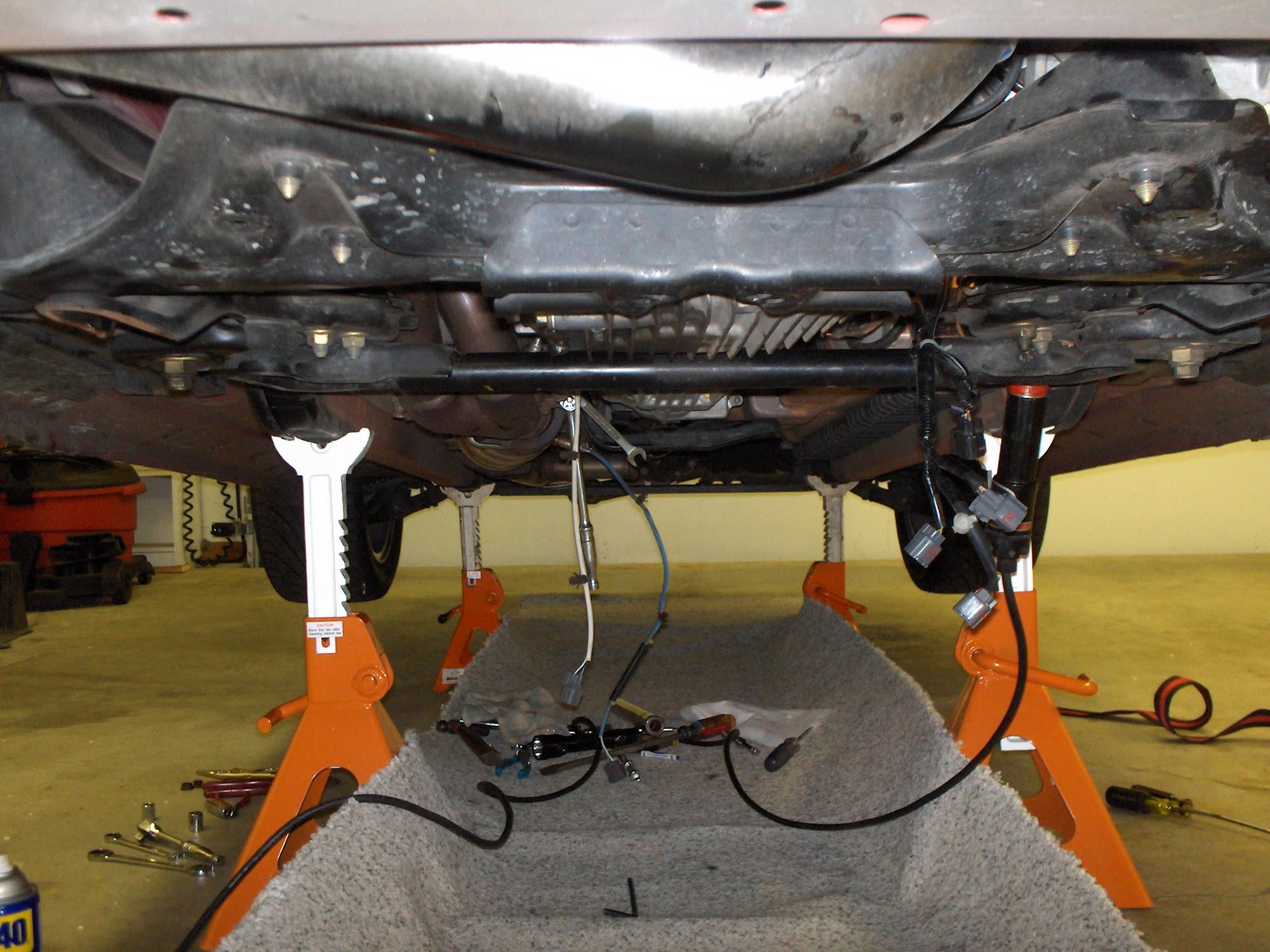

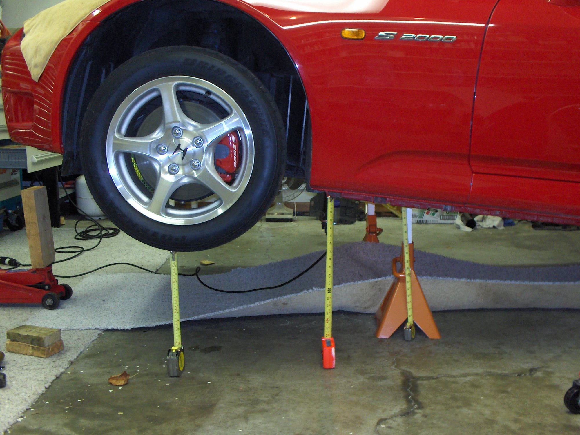

Unless you are a failrly good mechanic you will be in over your head. Do you realize that you will need to drop the engine and sub frame 4-6" to pull the transmission. This is not a job for the faint at heart. If you have never done a clutch this is not the car to practice on. I did mine alone on my back with jack stands but I have done a few others.

A few tips:
Lossen but DO NOT totally remove the upper starter bolt, it's a bitch to get back in.
Raise the car high enough of you will be struggling.
Once the tranny is all unbolted pull the clutch fork out of it's position, This is held by spring type retainers and it pullls straight out enough to disengage fron the throw out bearing, if you dont do this the trans will not come off as you will be fighting the PP.
The hex head allen fastners on the drive shat will be a pain, don't pull slowley on the wrench.Make sure you have a cleanly ground end and a short pc of pipe on the long end of the L wrench for leverage then pull swiftly and forcefully they will " snap" loose otherwise you will round the inside or the head and be forced to use vise grips or cut them. Good luck and keep us updated.
