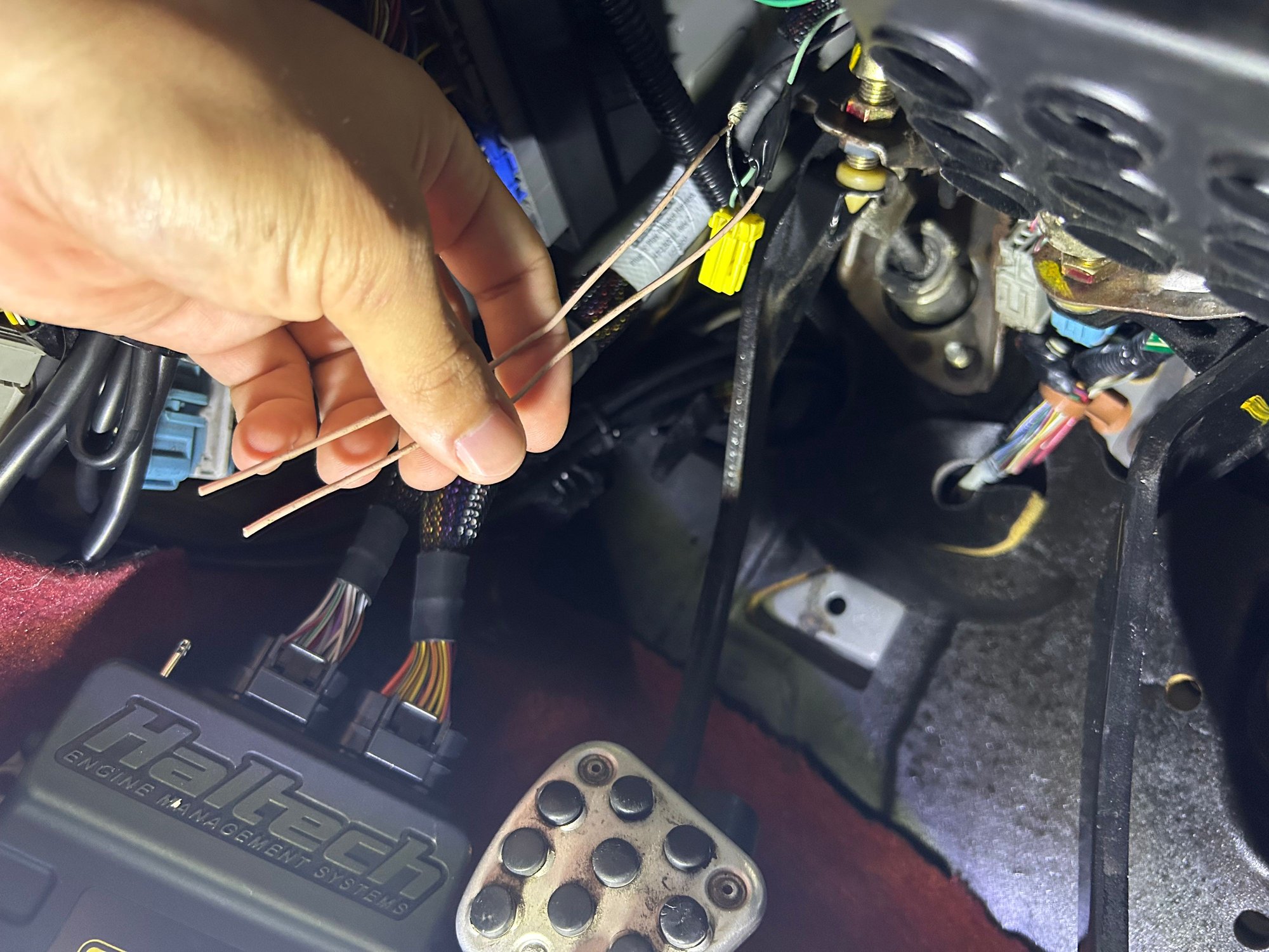

So I’m having a problem with starting my 01 right now, cars been sitting last few months but I never had this particular issue before.
go to turn the key over and I’ve got power everywhere but when I hit the start button I hear absolute nothing…
Fast forward a few days I read all over forums and saw I could try bypassing the clutch interlock switch with a paperclip but when I pull the switch out I see this wire is not connected? Is it supposed to be? I would guess it should be but I’m no expert so I come to you guys.
Is this the factory configuration I have here?

It's disconnected, which typically means whatever clip was jumping that connector fell out.

the connector is disconnected because I pulled it, I don’t think it was being jumped by anything before but when I tried to jump it nothing happened, I’m guessing it could be because that wire is disconnected?

those two cut wires likely went to a switch to defeat the interlock. just twist them together.

I see so connect those two cut wires and plug sensor back in? Or do I even need to plug it back

If you bypass the interlock with a wire (as opposed to some kind of switch), there is no need to plug it back in.
Its safer to bypass to another switch. I used brake pedal. Did a comprehensive diy writeup.
