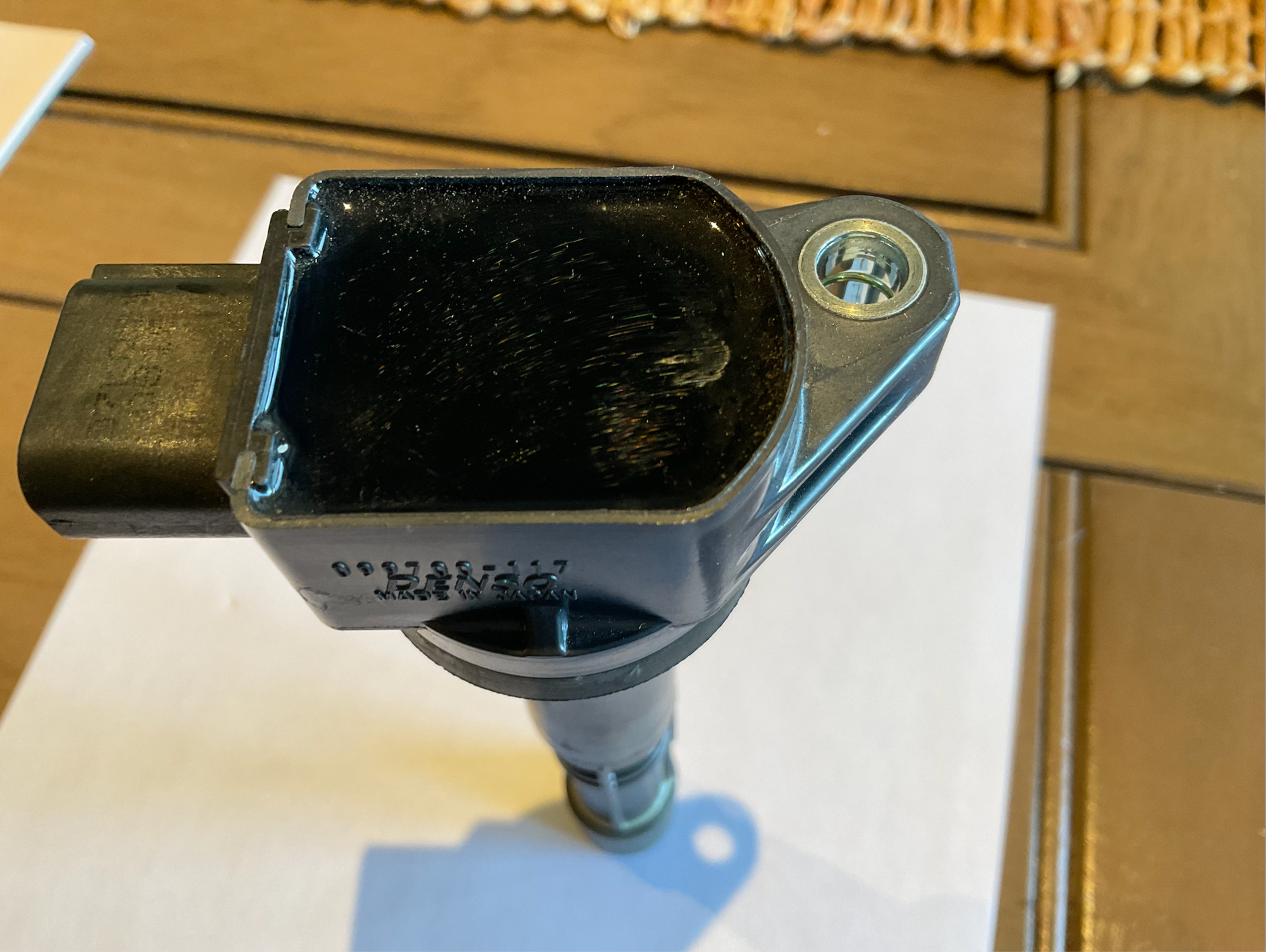

I am just about to order some for my 2009 and want to be sure I am getting the right thing. I have searched some Honda parts online and what I think is the correct part number changes to 007 at the end instead of S01 and it says it fits my 2009. It does not. Tried AI and got the following. I am ordering from Japan at $145 a pop.
I pulled one from my 2009 to see what I might find. These are the original OEM ones with 87K miles.
Originally Posted by Billman250
The 673-2301 coils (RAISED SQUARE) do not belong in any 2000-2005 S2000.
They are for 06-09 only.
You can use the oem AP1, or oem AP2 04-05. No raised square.
​​​​​​​There is no raised square on these.
Yes the raised square is right there.

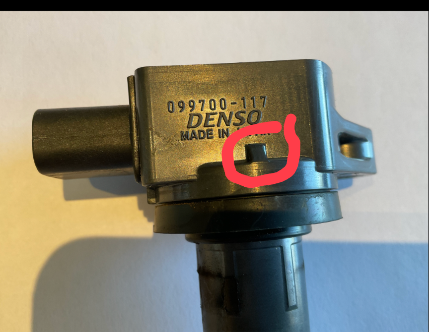

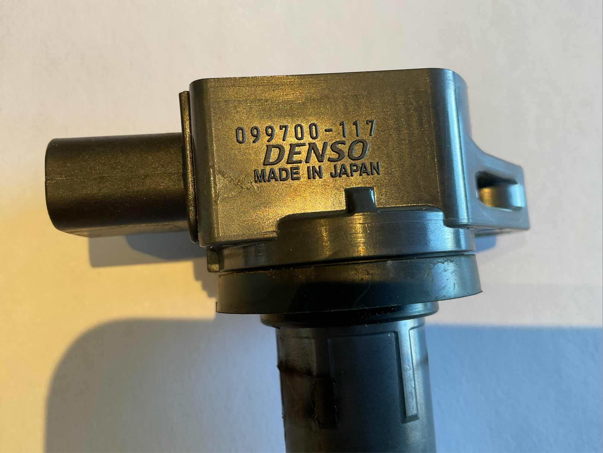

engifineer's Avatar
Joined: May 2014
Posts: 7,907
Likes: 2,478
Also has the 2nd rib on the head of the coil too. So the -117, and both of those ribs/raised square would seem to indicate those are 06+ going by what everything else says. Abd matches the year model. So like the FSM shows, having both ribs at the top seems to be only on the 06+. Mine do not have that 2nd rib on the top and are -115
