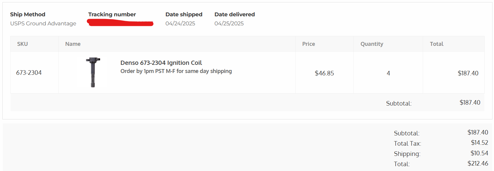

@cosmomiller I ordered 4 of these for my '06 last year. No problems so far. I'll check if I can find some old side-by-side pictures of them.
Great price. Well, mine are already paid for so I am along for the ride with the OEM ones. At least I saved a little than dealer or US online prices.

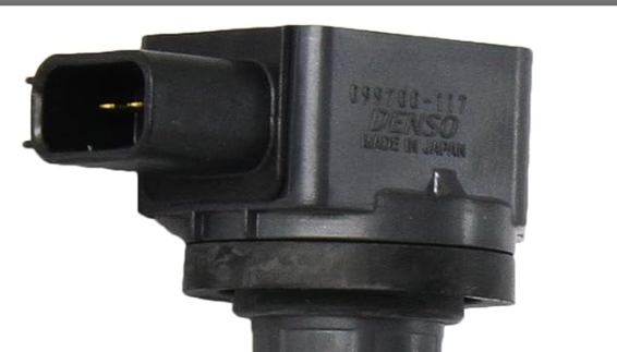

Originally Posted by Car Analogy
I feel like maybe people didn't see, or TL;DR, my looong (aka normal for me) post speculating about an answer that explains all the coil pn confusion.
A lot being asked now answered in there.
For the '06-'09 DBW ones, I answered and reconfirmed it last year when a replaced a bunch of parts after my misfire issues.
Gonna update this.
Just pulled out the packs from my 2006 DBW.
It has 099700-117 which corresponds with Denso PN#673-2304
