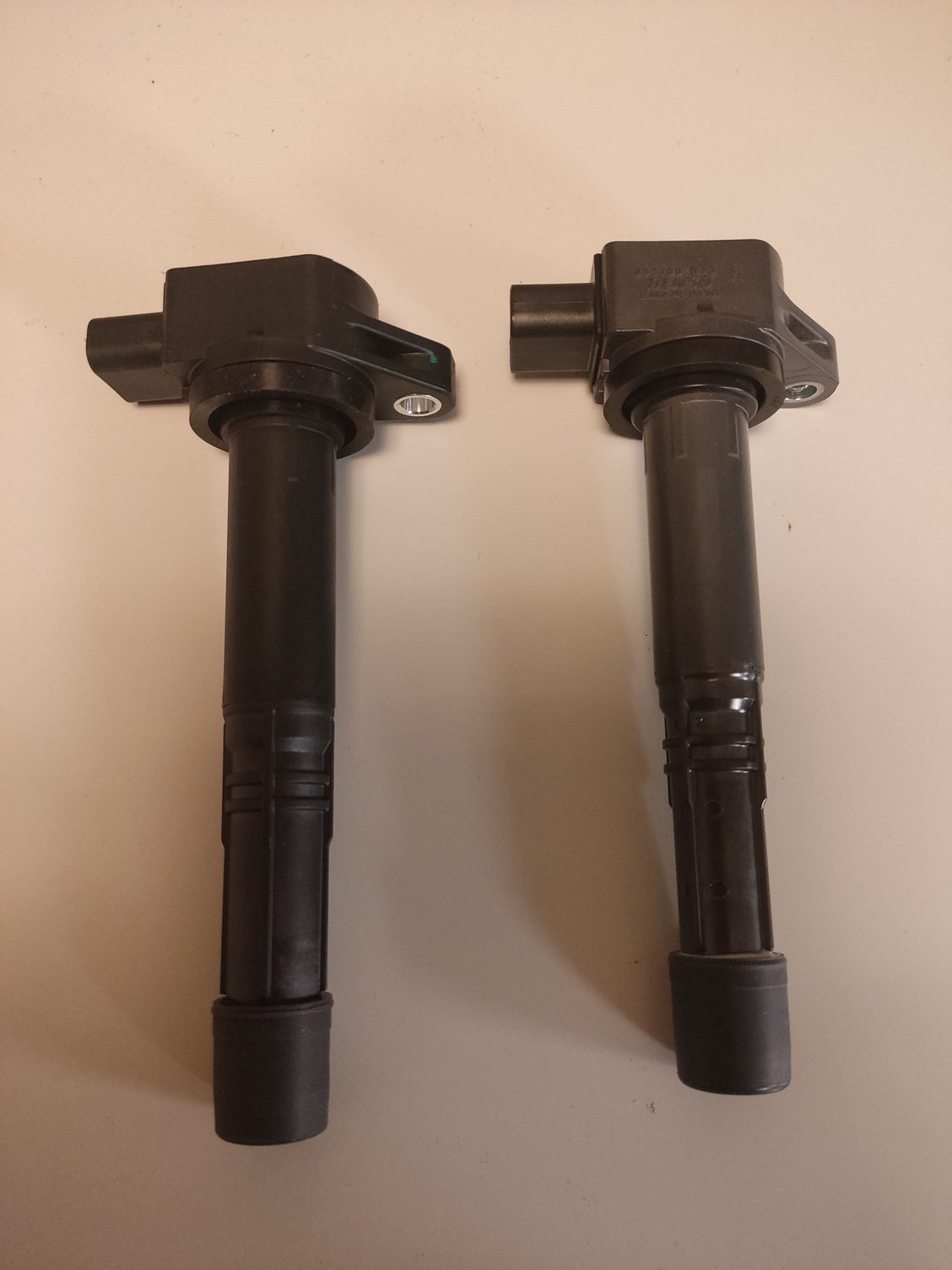

Here are some measurements I did many years ago when I got a set of Okada coils.
I did check inductance and capacitance as well, not sure how scientific those measurements were though.
Left Okada, to the right stock 2003 coils that as far as I know came with the car.

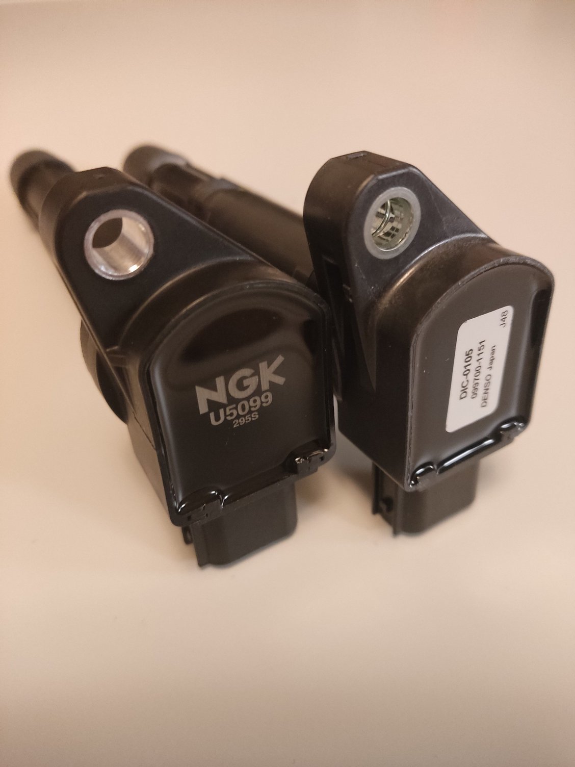

NGK Aftermarket Europe Nr. U-5099, Made in China. Has the "two ribs" on the head (As explained in the FSM for the DBW S2000 from -06 on). According to the application list, it fits all hondas with this type of coil, 970 OHM.
DENSO Aftermarket Europe Nr. DIC-0105, 099700-115 R , Made in Japan. Has only one "Rib". According to the application list, it fits all Hondas with the K engine, the S2000 is not listed in the aplication List. 1150 OHM.
Both looks and feel like real Quailty parts. As long as nobody could explain me the importance off the OHM values, i will go with the Denso UIC-0105, even if the S2000 is not listed in the apllication list for whatever reason.
