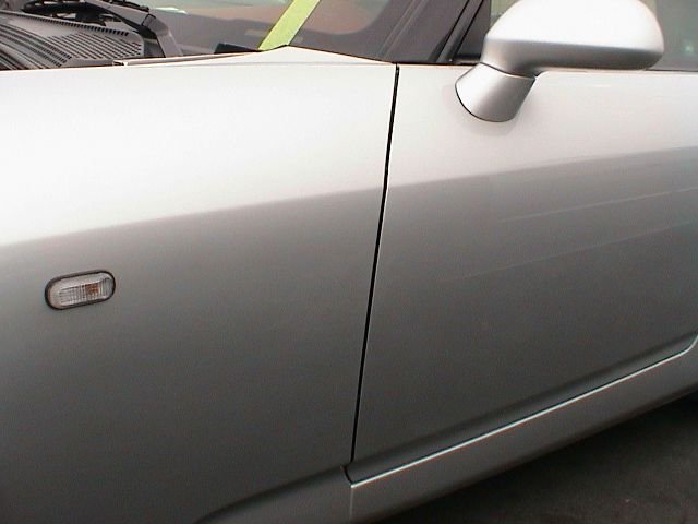

Yup. The color match was slightly off. And I mean SLIGHTLY. I could only pick up a difference in color on one seam, even though everything was painted at the same time.
After the initial painting was done, I checked the paint in sun and shade, and from every angle. I've been nit-picking about every little thing, and this is no exception.
The body shop has been completely tolerant and understanding about my nit-picking. They seem comitted to getting the car right, and making sure I am satisfied.
I asked them not to do any blending of the paint, if possible, even though they told me up front that silver, especially in metallic, is very hard to match perfectly.
They were right, and after my inspection, they did have to go back and paint again to do the blending. This meant more work for them, as it all could have been done in the first place, and I heard no complaints from them whatsoever.
Here's a photo of the mis-match using the best light and angle. It's not really perceptable anywhere else:

Although I don't like the idea of disturbing an undamaged panel, I believe that blending is a necessary evil. Even if they were somehow able to pull off a miracle and get the paint to match, you would be likely to start noticing a difference in the future. As the repaired paint & clearcoat gets weathered and baked by the sun, it will likely start to fade/change in a manner that is different from the factory paint & clearcoat. Without the blending, I think that it is highly likely that you would eventually be able to see a difference. The blending greatly reduces the chances that this will happen. In the end, I think that you will be happier the way that things actually worked out.

I believe that you are correct regarding the blending.
I was very apprehensive, at first, even though the guys at the shop tried to make me understand about the blending.
I feel kind of bad that I made them do the extra work, but I have read posts where some owners claim that they have received a perfect paint match, so I wanted to try it first.
I agree with you, now, that paint blending is the proper way to go, and I am getting happier, and more impressed with the work, as the project goes on.

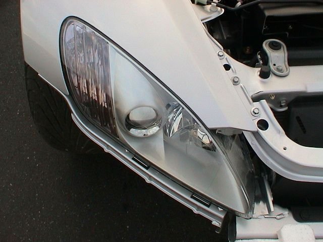

Here are a couple of shots of the new headlights installed in the car.
I think the clear diffusers would also look great. I chose the smoke-tinted ones because I see clear ones on all kinds of cars now, even on cheap american cars. I just wanted to be a little different.
It also gives the "negative" or opposite look to the black headlight inserts with the clear diffusers. I thought that would look interesting with the dark (CF) hood.
I think this will really change the look of the front, when it is done.

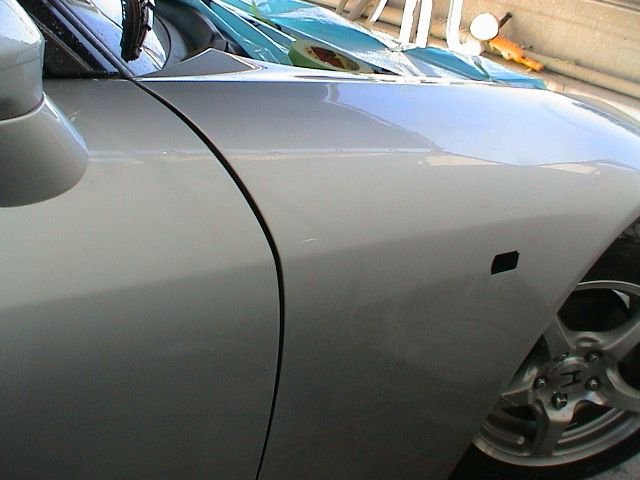

Here are a couple of shots showing the paint matching/blending between the front fenders and doors:
The paint job is now looking very good!
