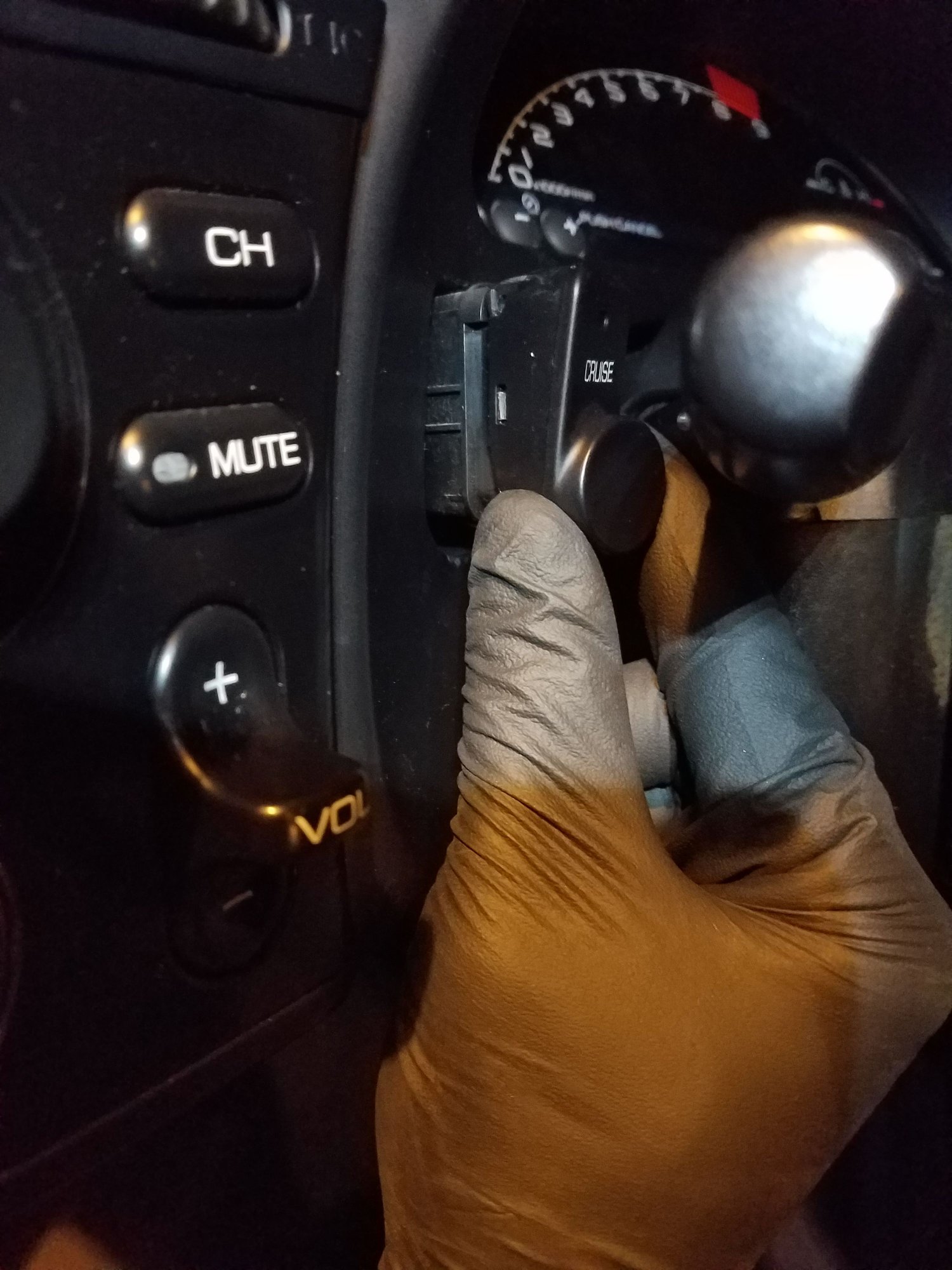

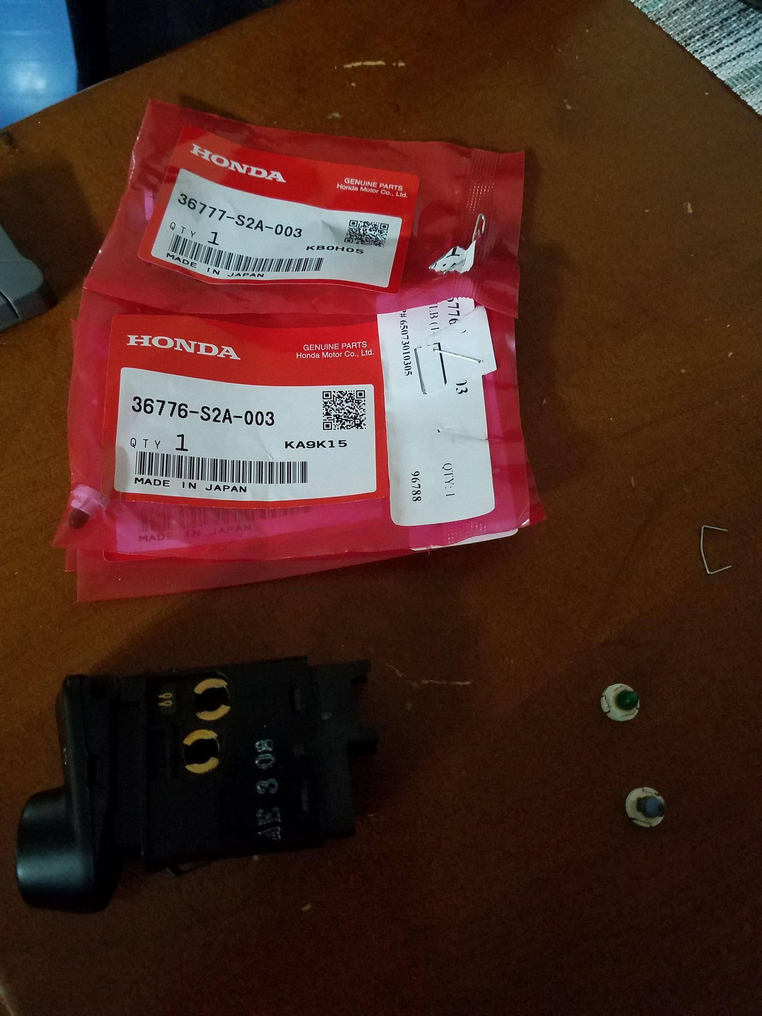

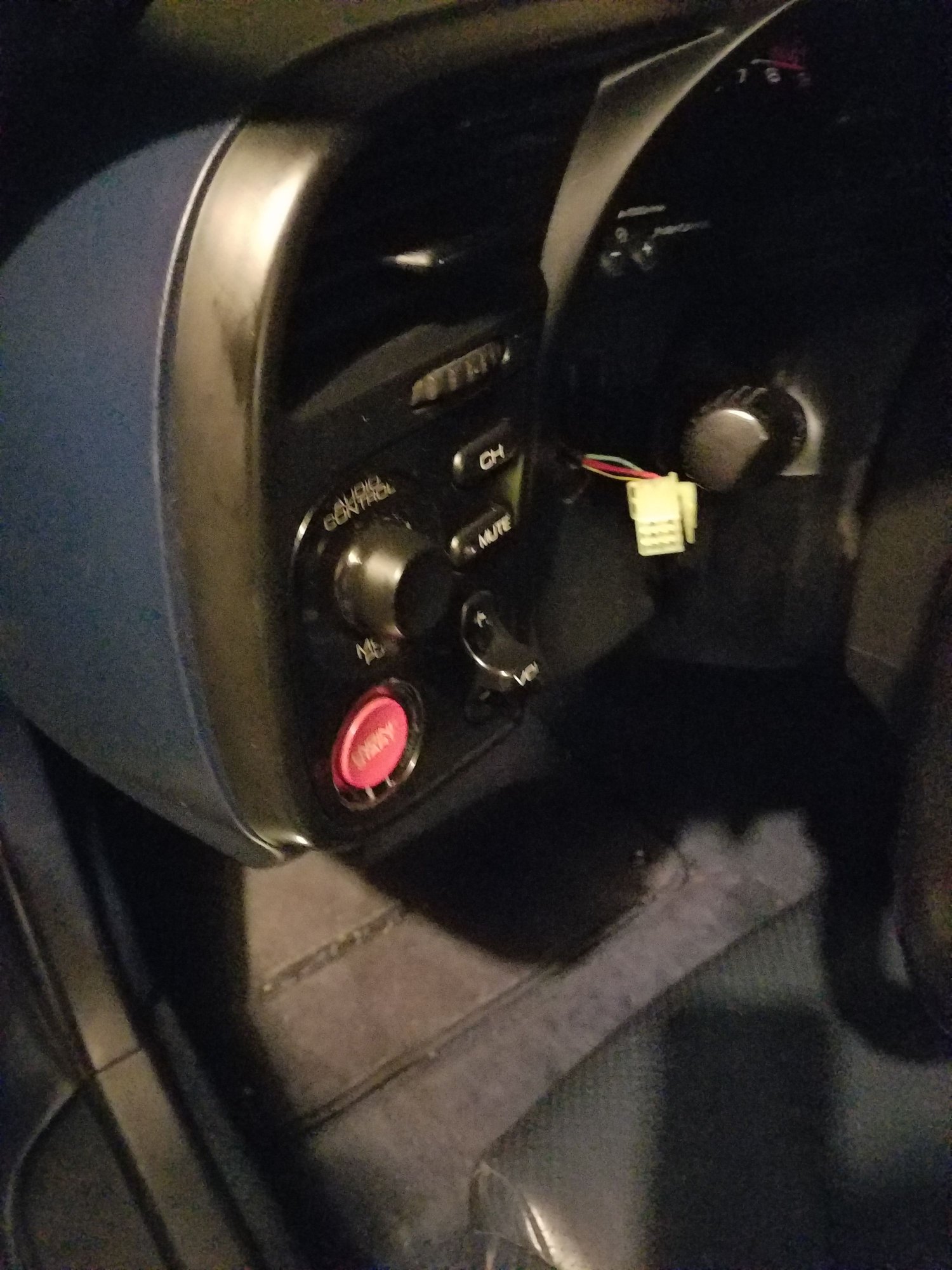

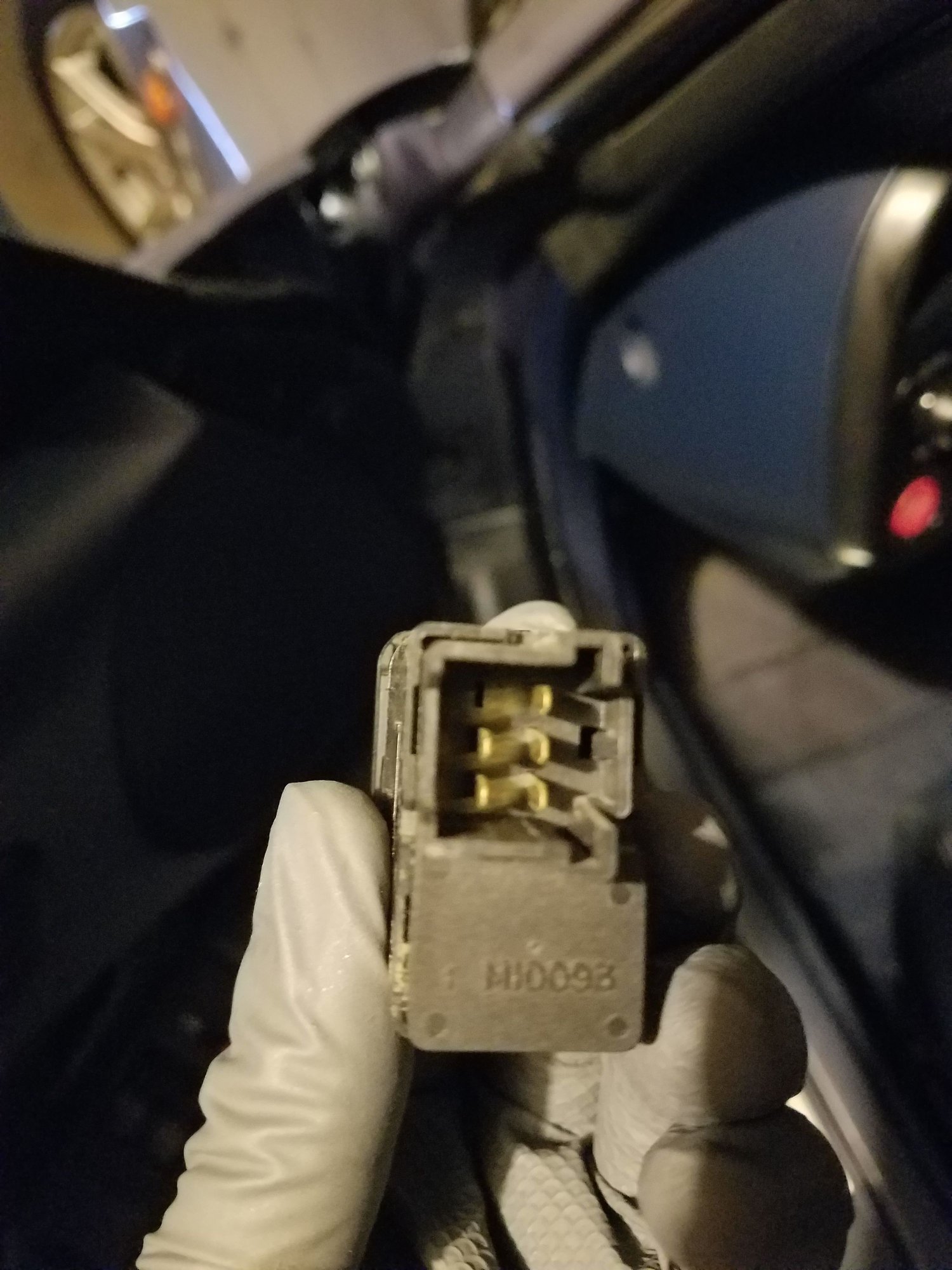

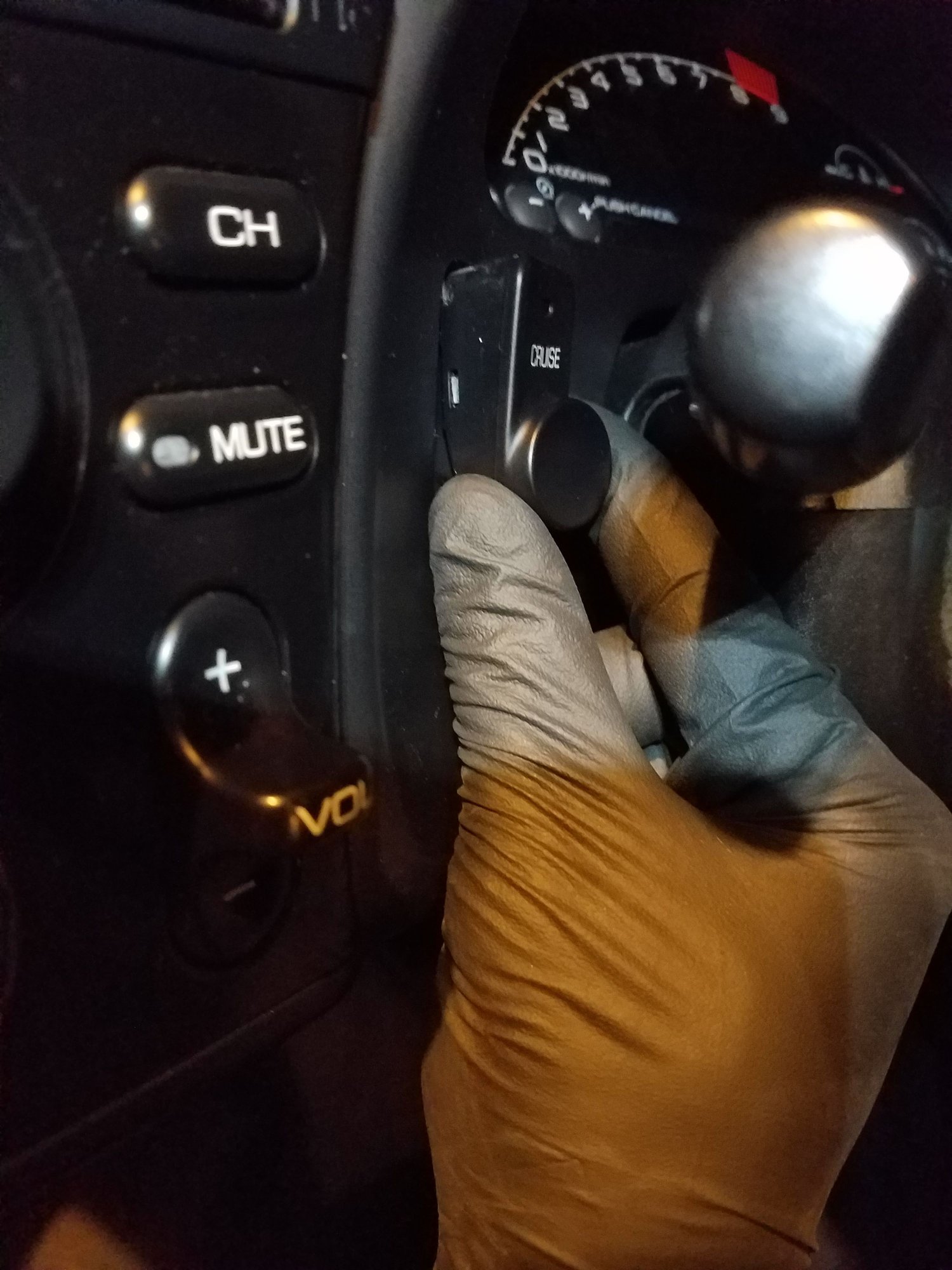

<<<BUMP>>> I just couldn't resist bumping this 2 year old post again. Well i just replaced a MY2000 with a MY2004 and noticed this cruise control module was not lit up and needed some TLC. Found out 1) the module at the current time is back-ordered with Honda. 2)There appears to be a like-for like switch replacement through Autozone website if you do a search.
Since my cruise control module and steering wheel buttons work, i realized it was probably just the bulbs. There are 2, one green and one amber/brown looking one. Anyway i tried prying it out and found it was much easier using two hands. Basically open the driver's door on my knees with my left arm curled under the dash, and right arm at the bottom of the switch, just use two fingers on each side of the switch. Push with two fingers from behind the dash, and push up and pull out at the bottom of the front of the switch, and it eventually will click out. The Service manual shows it out but just states "carefully pry it out of the instrument panel". I was really afraid of scratching something. Youtube showed a Civic with it out, but no one really said the best way to remove it. I saw one person say push the sides, but it's not the sides it's the top and bottom that wedge the switch in. Once you get it out, just unplug the harness, and replace the two bulbs with a slight turn using a small flat headed screwdriver. Reverse the installation to put it back in. Voila!
