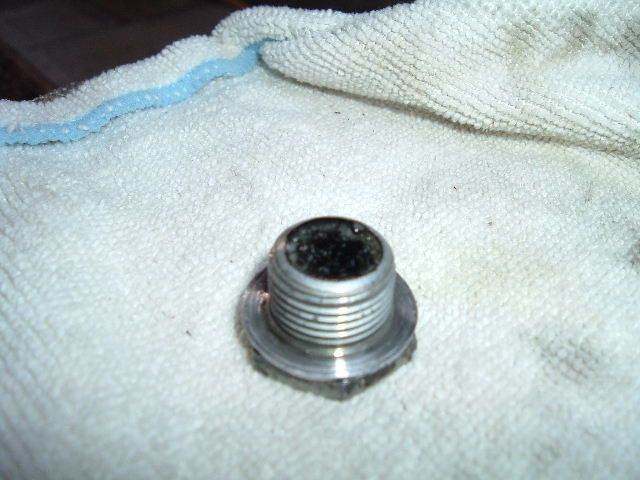

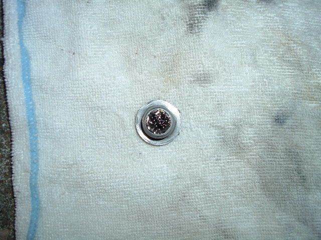

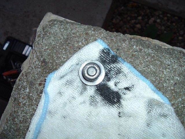

Although the majority of the noise sounds like the differential. I did change the fluid while I was under there and did come across some metal shavings. Nothing large and nothing too abnormal for a differential from what I have seen from others in the past, but still not good.
Cleaned off

you will always have metal shavings on the plug when you change the diff fluid.
however, we should clarify "metal shavings".
you should NEVER see anything larger than tiny glitter size specs of metal. it tends to crud together on the drain plug, so be sure to wipe it with a rag, and check the rag for metal fragments. as long as you have nothing but those tiny little shavings/glitter you're fine.

That's all there was, the glittery shavings.
Like I said above "Nothing large and nothing too abnormal for a differential from what I have seen from others in the past"
I still took a picture of the plug to get others opinions.
I truly appreciate the response.
