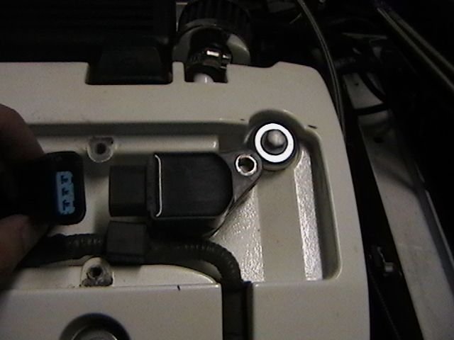

I was doing a compression test on my car today and decided to do a DIY for everybody!
You will need: Torque Wrech, 10mm socket, spark plug socket, socket extension, compression tester(about $25 from any auto store), allen wrech(not sure what size, its to take of the screws on the spark plug cover...i think M6)
Start the car and warm it up before beginning.
Turn off the car and remove the four screws holding the spark plug cover!
Then remove cover and unscrew the four bolts(10mm) holding the coils in place.
Unclip the clips that are on the coils.
Remove the four coils.
Now go remove the fuel pump fuse!

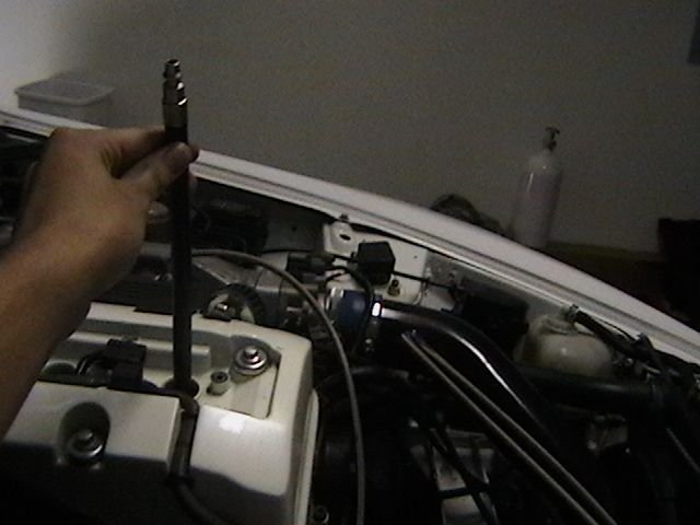

Remove all the spark plugs.
Screw on the tube that comes with the compression tester on the cylinder you want to test.
Then add the gauge.

Replace the coils. Connect the clips and make sure you hear a "CLICK" when putting them on.
Torque the coil bolts to 7 ft/lbs.
