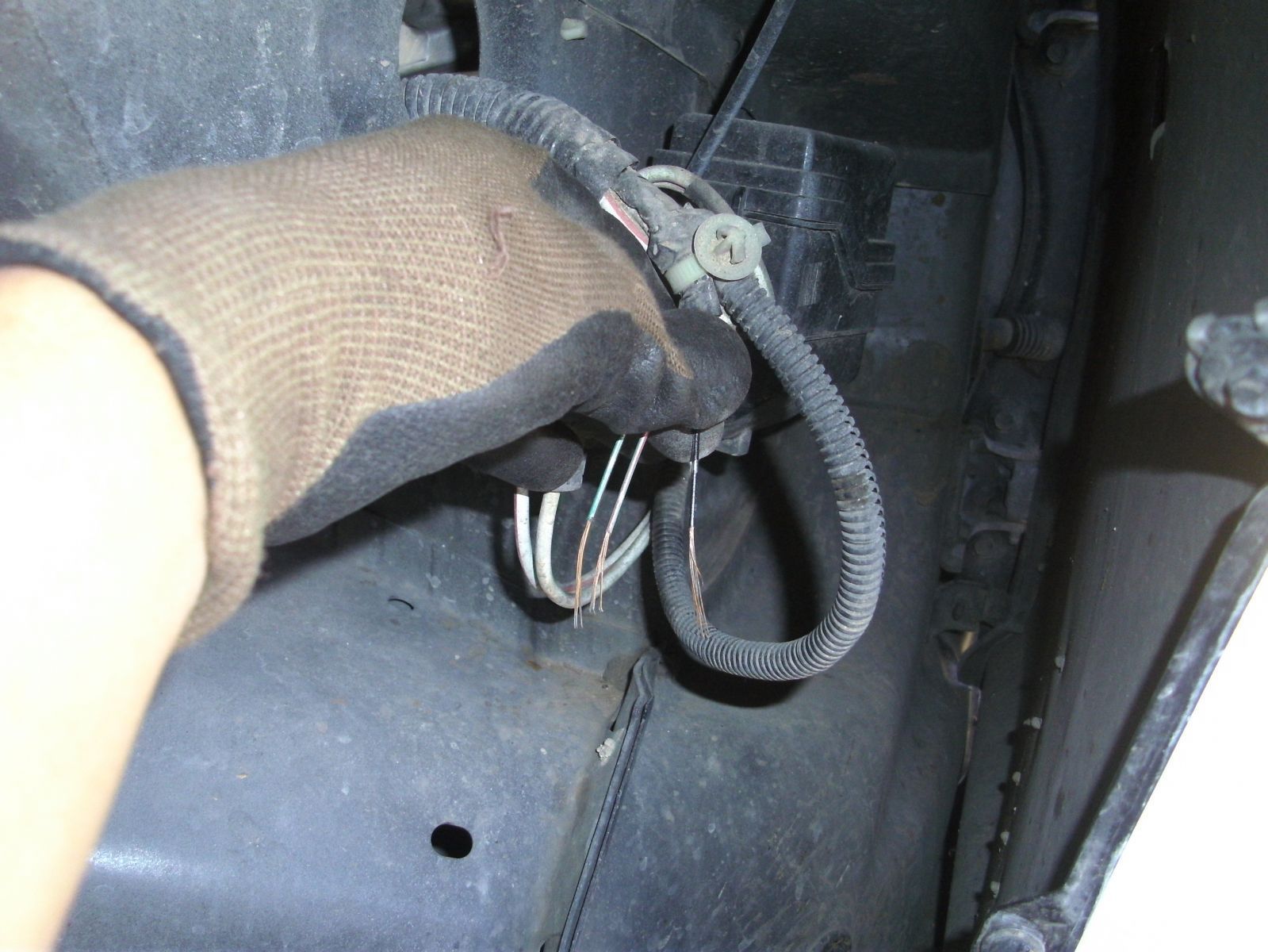

Neglected to tell anyone that the previous owner took the side markers on the fenders off the car. So I looked behind the fender and found cut wires on both the driver and passenger side. They just cut out everything for those side markers.
Well on the driver side there are 3 cut wires as opposed to 2 on the passenger side.
The 2 of the cut wires are green with a red stripe and 1 black. I'm pretty sure that this is my problem and was wondering what the hell do I need to connect these too to possible get my driver side blinker and running light working again? Also have a friend test the blinker socket. I have good ground but no power to the socket.
Old Dec 18, 2009 | 03:23 PM
manolo.cabasal's Avatar
Joined: Jul 2009
Posts: 231
LOL, i feel dumb. I fixed it....connected the 2 wires (green w/red stripe) and now my blinker is working.
