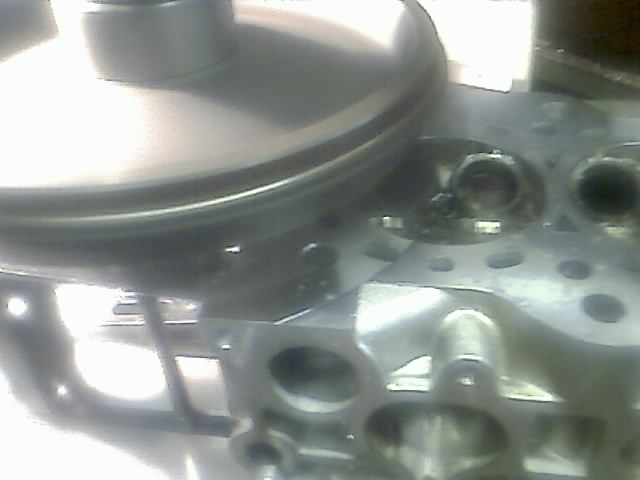

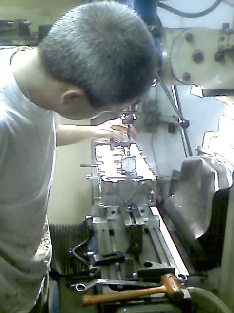

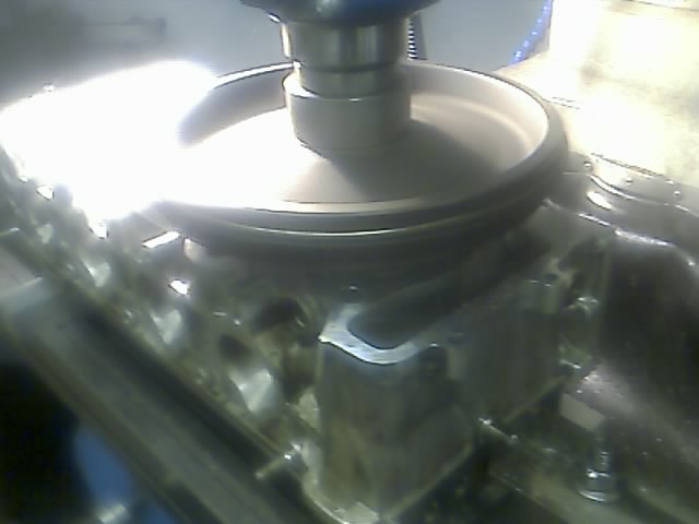

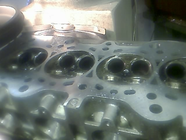

Unfortunately due to Chris' F3 commitments we haven't got around to doing much.
Last night we assessed the head and found it had a 2 thou dip in the middle on the exhaust side.
So will milled a few thou off to get it nice and level.
Will do a little reassembly on Thursday then spend all day Saturday getting it back together. If all goes to plan on Sunday she will go back in the car.
