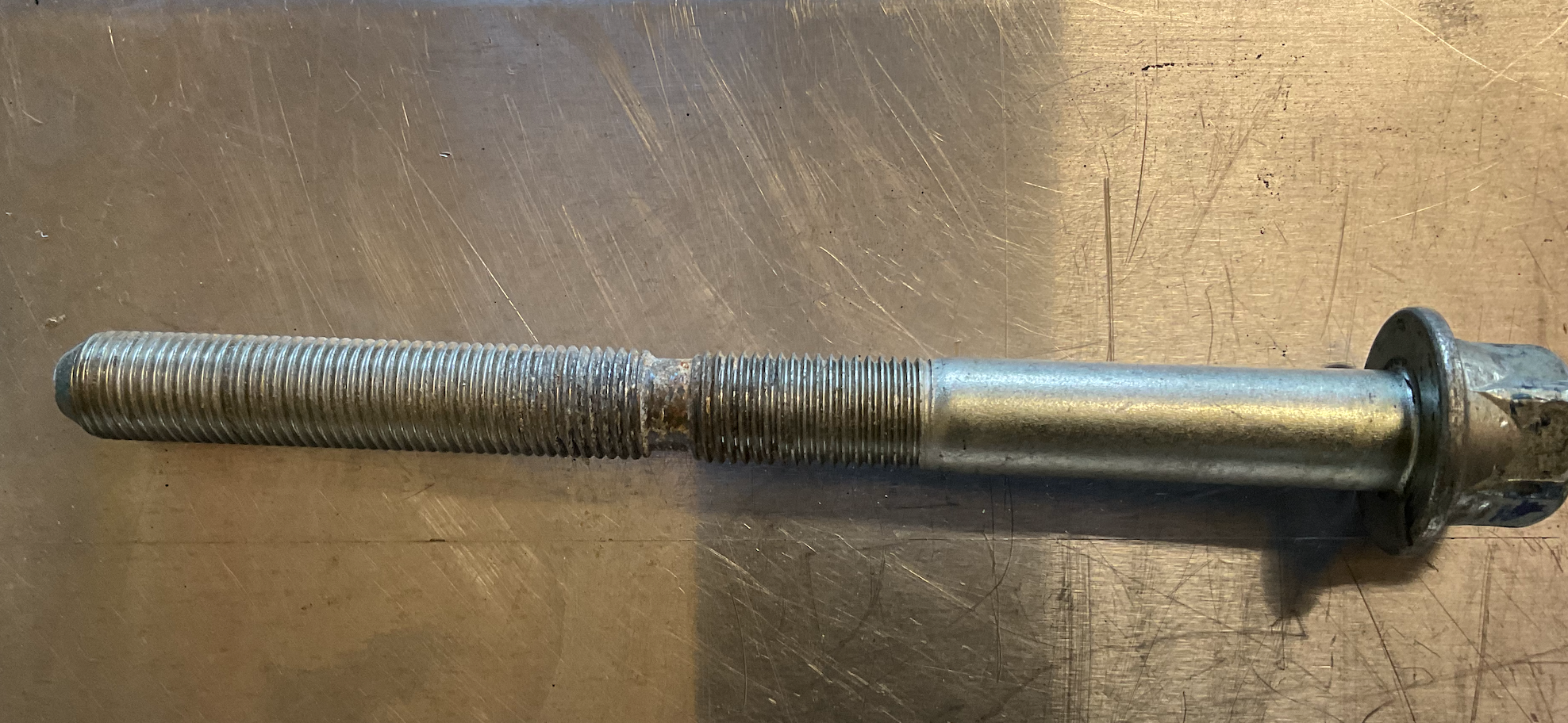

I had to do clutch replacement for my MY '01 S and off course needed to lower the subframe. Front bolts (nr. 10 on picture) were badly seized and both snapped. I had to drill and re tap.
I ordered 2 new bolts. Part number: 90162-S2A-000
Old bolt probably look'd like this:
But new bolt looks like this:
Amazon Amazon
Part number is correct. On new bolt thread is too short. It goes thru the thread in chassis before it tightens against the subframe.

Looks like the part diagram is incorrect, you should have ordered 90161-S2A-000

You were right. Got the right bolts. Thanks again
