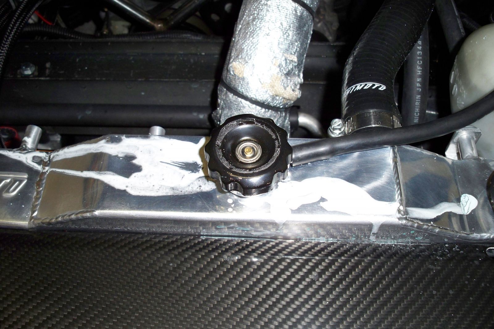

well i put the old cap on and it ran good last night and i had no issues on my way to work this morning. i was stuck in bumper to bumper traffic for about ten minutes on my way home and i started to smell coolant and this is what i found. so i am starting to think that maybe it might be the filler neck
